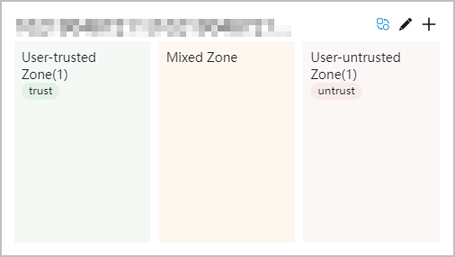

- Check the device card in the Device Security Zone area.
If tenants see a message indicating that ports in the device security zones are reversely connected, it indicates the cables are incorrectly connected to the Qiankun Shield devices. In this case, tenants need to exchange the uplink and downlink interface connection on the local Qiankun Shield devices.
Figure 1 Device security zones reversely connected
