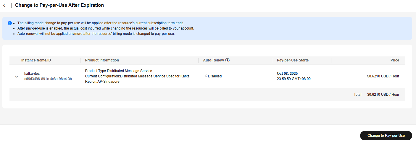

- Confirm the subscription change details, and click Change to Pay-per-Use After Expiration.
Figure 1 Changing to pay-per-use upon expiration
