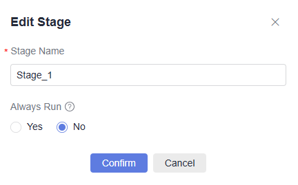

  7. Select the target stage, click . The Edit Stage window is displayed. Set Always Run to No and click Confirm.
    Figure 1 Editing a stage

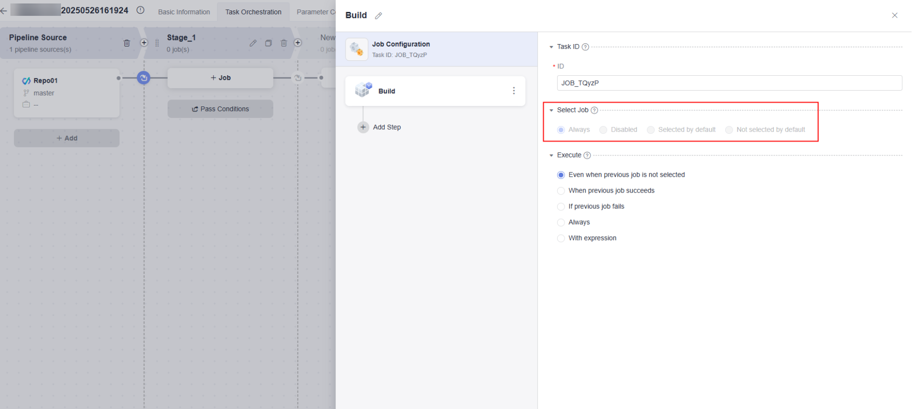

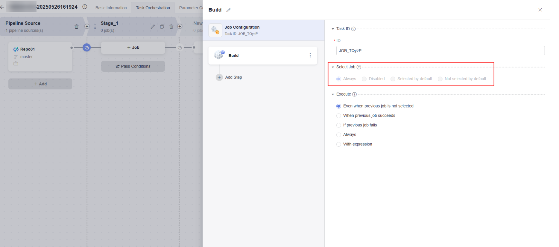

  8. Click a job card. In the displayed window, click Job Configuration, and set Select Job as needed.
