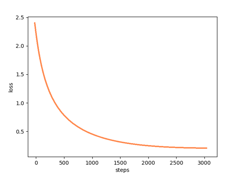

Figure 1 Normal loss curve: smooth descent

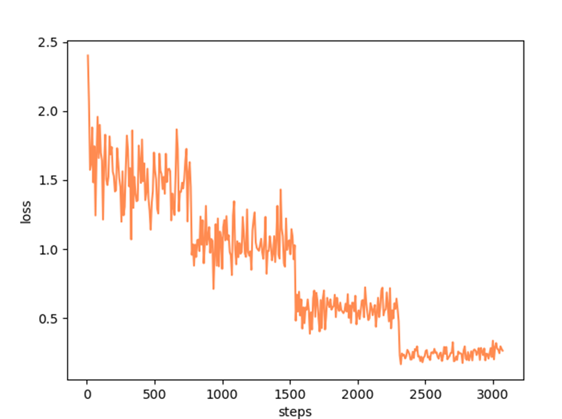

Figure 2 Normal loss curve: gradient descent

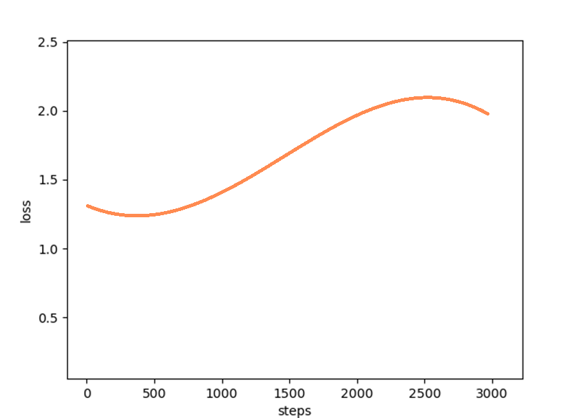

  • The loss curve increases. The possible cause is that the data quality is poor or the learning rate is too large. As a result, the model flaps around the optimal solution or even overshoots the optimal solution. As a result, the model fails to converge. You can try to improve the data quality or reduce the learning rate.
    Figure 3 Abnormal loss curve: increase

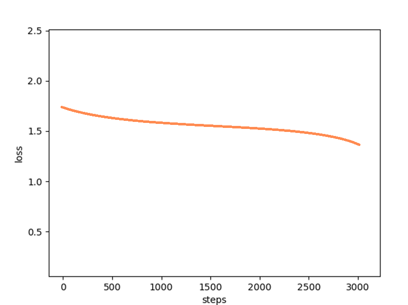

  • The loss curve is smooth but remains high. The possible cause is that the target task is difficult or the learning rate of the model is too small. As a result, the model converges slowly and cannot achieve the optimal solution. You can try to increase the number of epochs or the learning rate.
    Figure 4 Abnormal loss curve: smooth but high

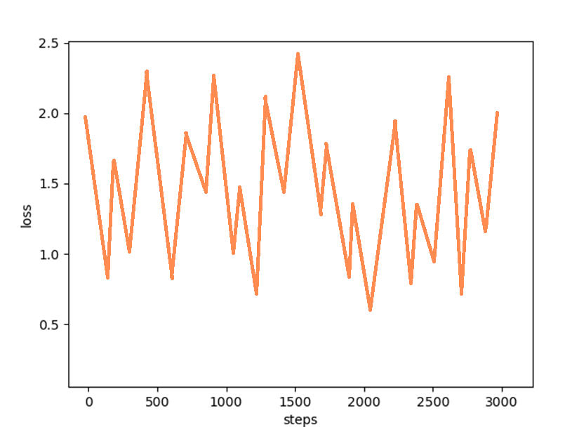

  • The loss curve jitters abnormally. The possible cause is poor data quality. For example, the data has noise or is unevenly distributed. As a result, the training process is unstable. You can try to improve data quality.
    Figure 5 Abnormal loss curve: abnormal jitter
