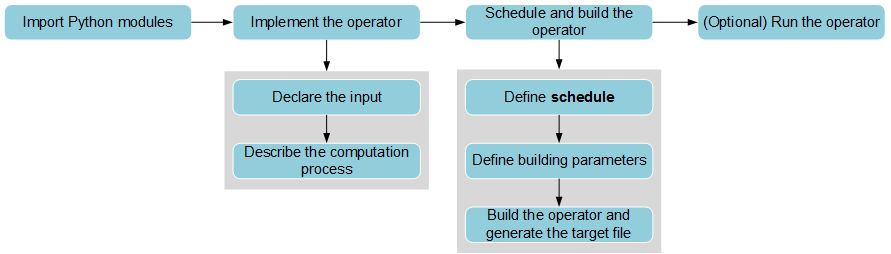

The code of a TE operator is developed in Python. Figure 1 shows the implementation procedure.
