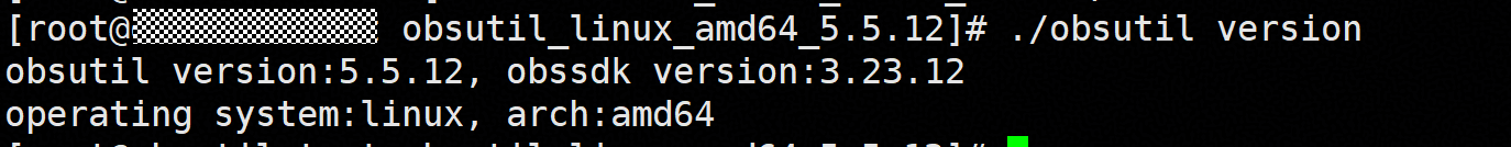

  6. Continue to run the following command in the directory. If the version number of obsutil is returned, the installation is successful.
    ./obsutil version
    Figure 1 Successful installation
