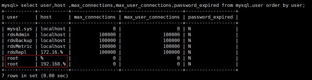

- Query the user table and check user information.
The command output indicates that two root users exist.
When the client is in the network segment 192.168.***.***, RDS for MySQL authenticates the user root@'192.168.%'. However, the password of user root@'%' is used to log in to the database, which causes a login failure. Therefore, ERROR 1045 (28000) is caused by an incorrect password.
User root@'%' is used for setting a password when you create a DB instance on the RDS console.
