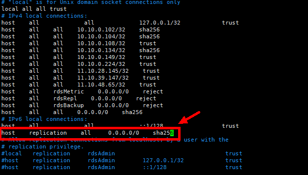

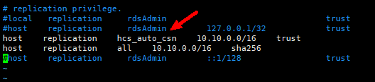

find / -name "pg_hba.conf" Or find / -name "gs_hba.conf"
- Open the pg_hba.conf file. Retain sha256 and insert trust of the specified single-mode task user in the line above sha256.
- Run the following statement as a system administrator on the source database or restart the DB instance to apply the change:
select pg_reload_conf();
