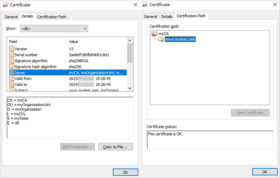

Private certificate
A private certificate is an end-entity certificate, which is installed on an end entity, including certificates used for the client (or client certificates) and certificates used for the server (or server certificates). An end-entity certificate is at the bottom layer of a certificate chain and is used to authenticate an entity. It cannot be used to issue a certificate and is a credential for HTTPS communication between the entity that owns the certificate and other entities. Figure 1 shows the content of a private certificate.
Figure 1 Private certificate

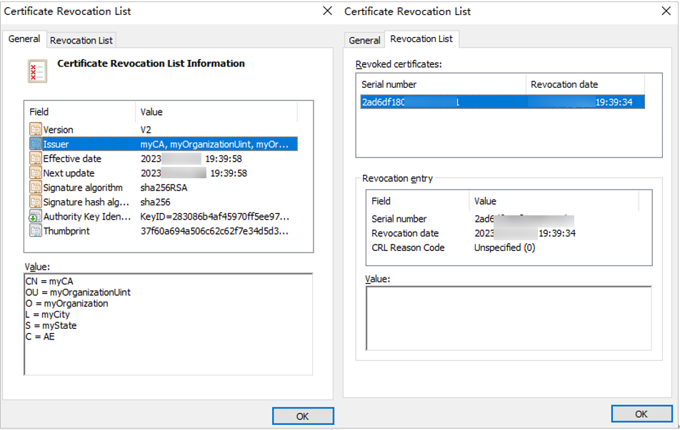

Certificate Revocation List (CRL)
A certificate revocation list (CRL) is a list of certificates revoked by the parent CA when they are still valid. The revoked certificates include subordinate CAs and private certificates. A CRL is a structured data file in a fixed format. It contains the issuer information, time when the CRL takes effect, time when the CRL is updated next time, issuing algorithm, fingerprint, as well as the serial number, revocation time, and revocation reason code of a revoked certificate. Figure 2 provides more details.
Figure 2 Certificate Revocation List (CRL)

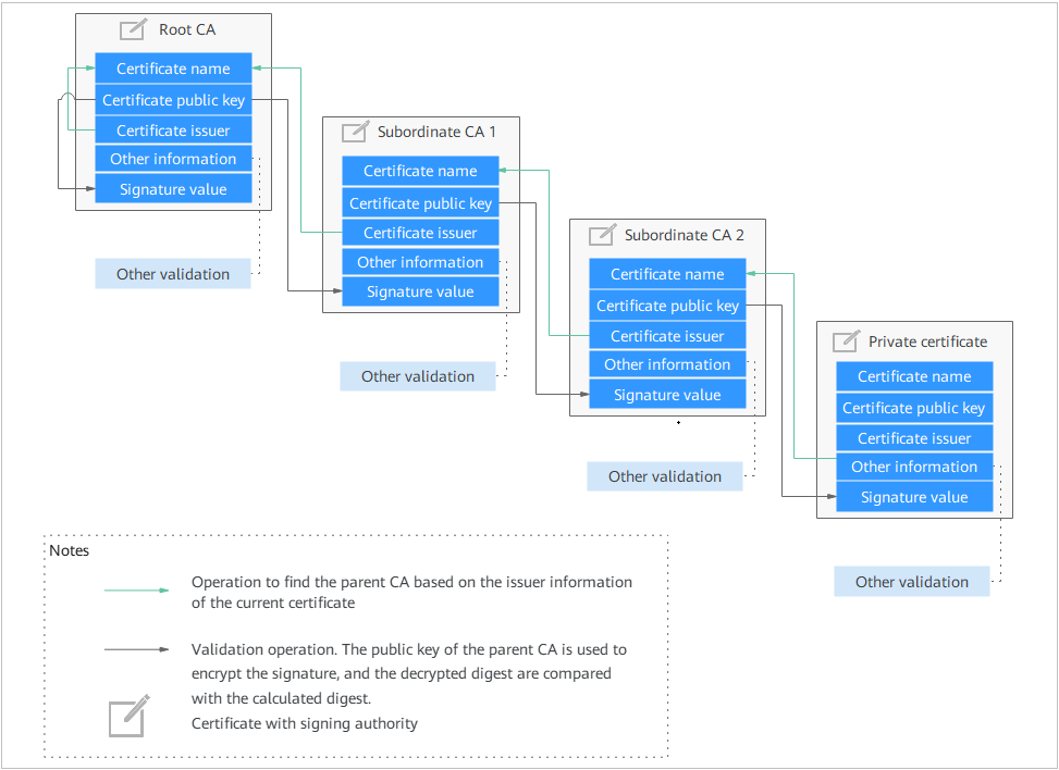

Certificate chain
A certificate chain is a file that combines all certificates from the root CA to the private certificates in a fixed sequence. A certificate chain is used to validate certificates layer by layer. Figure 3 shows an example certificate chain.
Figure 3 Certificate chain
Certificate validation involves the following aspects:
  • Integrity of the certificate chain and validity of certificates
  • Validity of the root CA, which is preinstalled in its trust store.
The following information is validated during the validation process:
  • Subject the certificate owner claims, such as the domain name of the server
  • Certificate validity period
  • Key usage, such as key negotiation and digital signatures.
  • Digital signature
  • Whether the certificate has been revoked.
    Not all validation items are listed here. The X.509 certificate allows users to add multiple customized extension items. For details, see related international standards.
