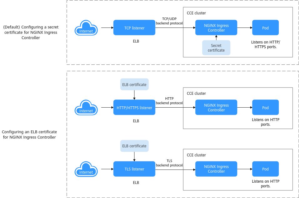

CCE provides the following options for configuring ingress certificates for the Nginx Ingress Controller add-on:
  • Secret certificate. Import the required certificate to a CCE secret and specify the default server certificate (default-ssl-certificate) for the add-on.
  • ELB certificate. Use an ELB certificate created on the ELB console. There is no need to specify a secret certificate for the add-on.
Figure 1 Differences between the two methods of configuring certificates for the NGINX Ingress Controller
This section describes how to configure an ELB certificate for the NGINX Ingress Controller add-on and use that ELB certificate to manage the certificates used by requests.
