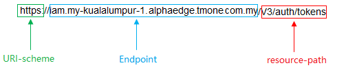

For example, to obtain an IAM token in the my-kualalumpur-1 region, obtain the endpoint of IAM (iam.my-kualalumpur-1.alphaedge.tmone.com.my) for this region and the resource-path (/v3/auth/tokens) in the URI of the API in Regions and Endpoints. Then, construct the URI as follows:
https://iam.my-kualalumpur-1.alphaedge.tmone.com.my/v3/auth/tokens
Figure 1 Example URI
To simplify the URI display in this document, each API is provided only with a resource-path and a request method. The URI-scheme of all APIs is HTTPS, and the endpoints of all APIs in the same region are identical.
