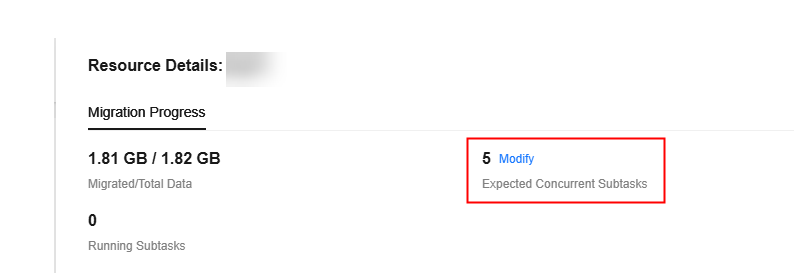

- (Optional) Adjust the maximum number of concurrent subtasks in the migration workflow. Reducing the maximum number of concurrent subtasks may decrease the migration speed.
- Click the workflow name to view its details.
- Click the corresponding resource name. View the Migration Progress area.
- Click Modify above Expected Concurrent Subtasks and configure an appropriate value. There cannot be more than 10 concurrent subtasks for each online migration node. For example, if there are 2 online migration nodes, the maximum number of subtasks can be 20 or any number below.
- Click Confirm.
