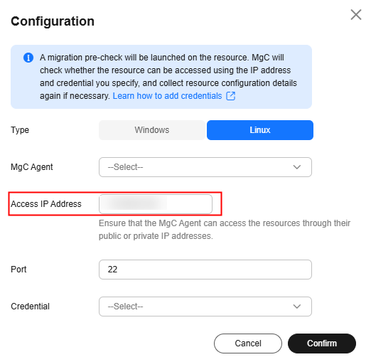

- Check whether the access IP address configured for performing the migration readiness check is correct. Ensure that the MgC Agent can connect to the source server through the provided IP address and port.
- If the address is incorrect, correct it and try again.
- If the address is correct, go to step 2.
