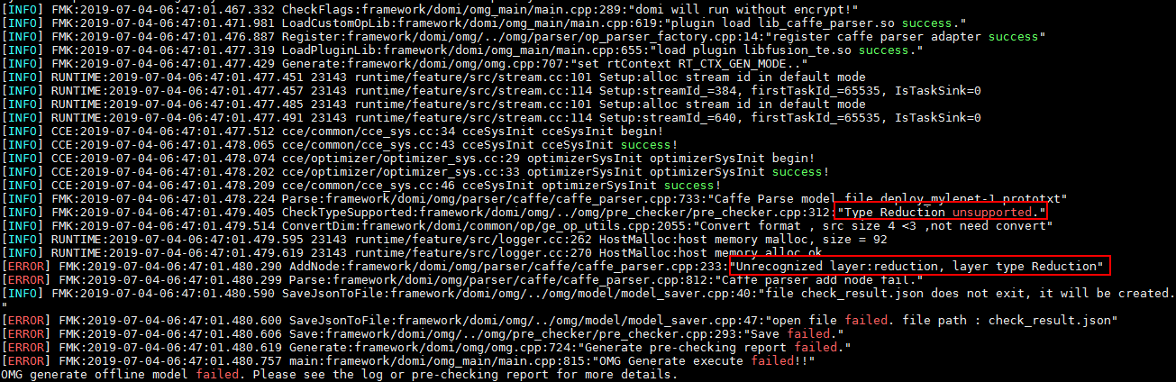

When the omg command is run to convert a model, the error messages "Type XXX unsupported" and "Unrecognized layer:xxx, layer type XXX" are displayed, as shown in Figure 1.
Figure 1 Model conversion error messages
As shown in Figure 1, the Reduction operator is used as an example for illustration.
