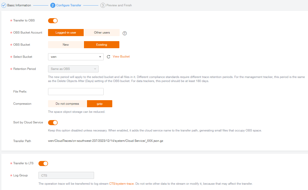

- In the Configure Transfer step, configure parameters related to transfer logs to OBS, enable Transfer to LTS, and click Next.
Figure 1 Configuring transfer parameters
