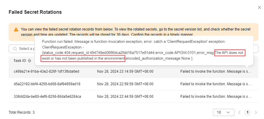

  5. In the Version area, click the number next to Failed rotations and check whether the secret rotation failure record contains The API does not exist or has not been published in the environment. If yes, go to the next step.
    Figure 1 Viewing the cause of the secret rotation failure

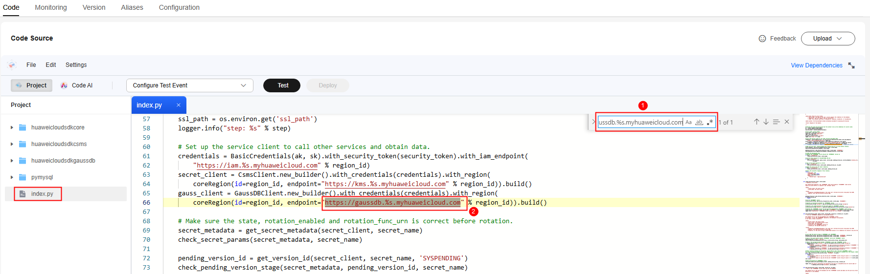

  6. Return to the secret details page. In the secret information area, click the FunctionGraph rotate function to go to the FunctionGraph console.
  7. Locate the index.py file and search for https://gaussdb.%s.myhuaweicloud.com in the code source.
    Figure 2 Editing the index.py file

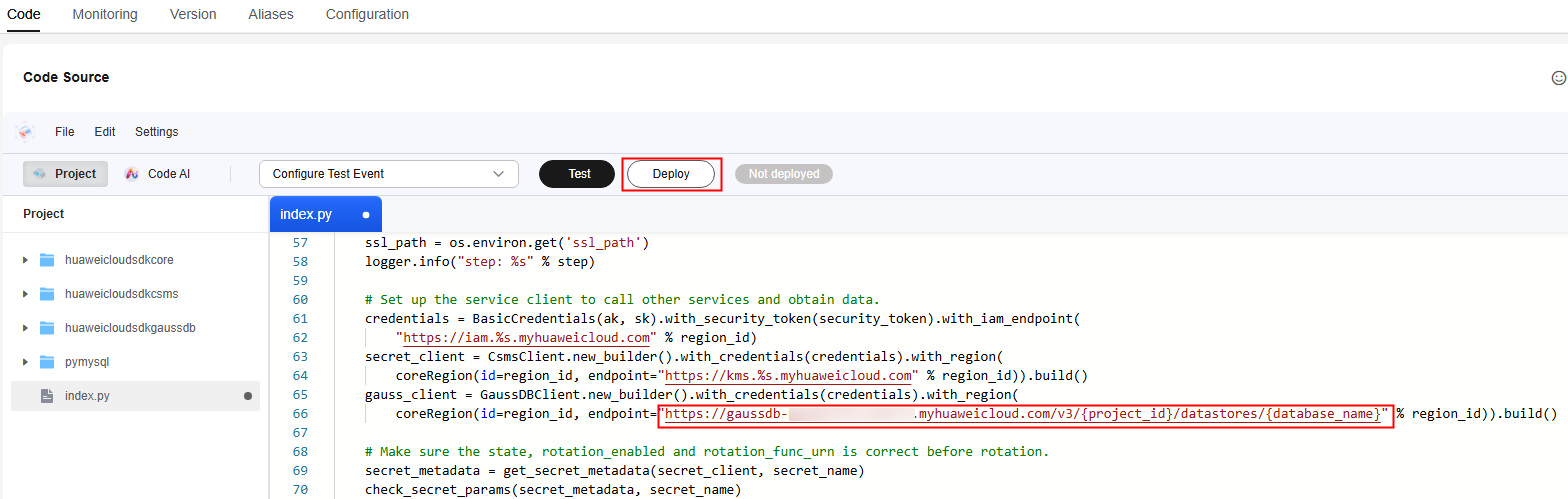

  8. Call the TaurusDB API to obtain the database engine version and copy the TaurusDB database domain name in the current region.
  9. Replace https://gaussdb.%s.myhuaweicloud.com in the Step 7index.py file with the copied domain name and click Deploy.
    Figure 3 Changing the domain name

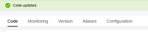

    When the message Code updated is displayed on the FunctionGraph console, the modification is successful.
    Figure 4 Code updated
