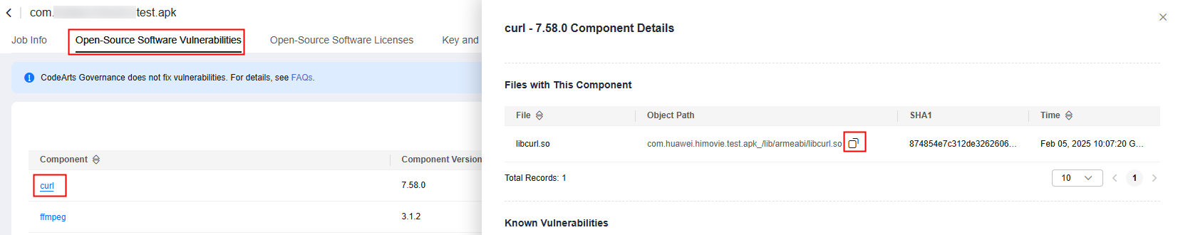

- Check the Open Source Vulnerability Analysis tab page.
Locate the files according to the file path displayed on the report details page or in the report. If the detected software does not exist or the software version number is incorrect, no further analysis is required.

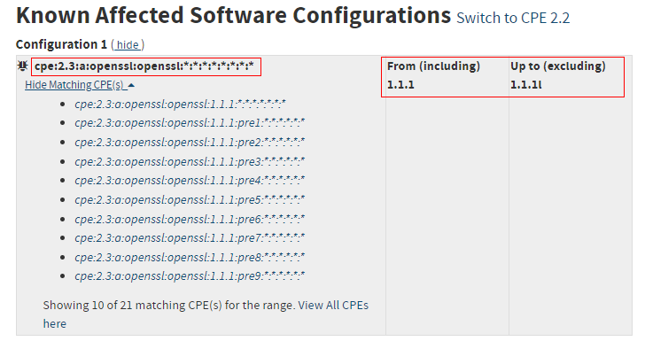

- General analysis: Confirm the scope of each vulnerability. For example, CVE-2021-3711 is listed in the Known Affected Software Configurations area by NVD, as the following figure shows. You can check whether the vulnerability affects the software version that you are using.

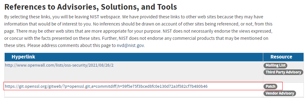

- Refined analysis: Since some vulnerabilities exist in functions, you can refer to the patches listed in the communities mentioned above to learn the vulnerability details, affected functions, and fixing methods, as shown in the following figure, and confirm whether the vulnerability affects the software that you are using.
