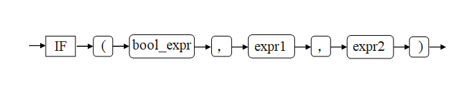

  • IF
    Figure 8 shows the syntax of an IF expression.
    Figure 8 if::=
    If the value of bool_expr is true, expr1 is returned. Otherwise, expr2 is returned.
    See Conditional Expression Functions for examples.

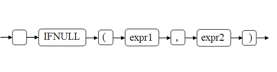

  • IFNULL
    Figure 9 shows the syntax of an IFNULL expression.
    Figure 9 ifnull::=
    If expr1 is not NULL, expr1 is returned. Otherwise, expr2 is returned.
