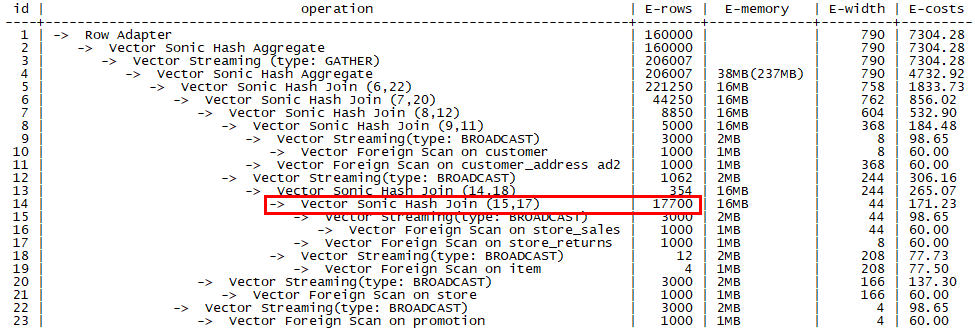

Hint the query plan in Examples as follows:
2
explain
select /*+ leading(store_sales store_returns) rows(store_sales store_returns *50) */ i_product_name product_name ...
Multiply the result set of joined store_sales and store_returns by 50. The optimized plan is as follows:
The estimated number of rows of the operator in row 11 is revised to 17,700, with the original estimate being 354 rows.
