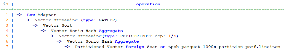

  • Example
    The TPCH Q1 parallel plan is used as an example.
    In this plan, implement the Foreign Scan and HashAgg operator parallel, and adds the Split Redistribute data exchange operator.
    Operator 5 is the Split Redistribute operator. dop: 1/4 indicates that the DOP of the sender and receiver threads of Split Redistribute is 4 and 1, respectively. That is, the lower-layer Hash Aggregate operator 6 is executed based on the DOP 4. The upper-layer operators 1 to 4 are executed in serial mode.
    You can view the parallelism situation of each operator in the dop information.
