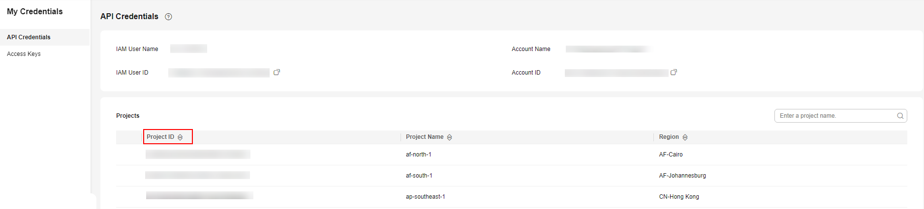

Obtaining a Project Name on the Console
To obtain a project name on the console, take the following steps:
  1. Log in to the CCI 2.0 console.
  2. Hover the pointer over the username in the upper right corner and choose My Credentials from the drop-down list.
    On the API Credentials page, view projects in the project list.
