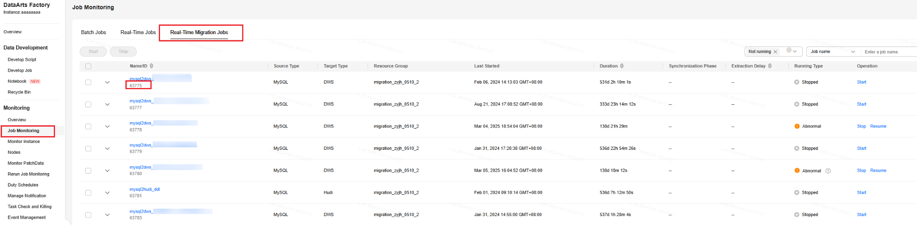

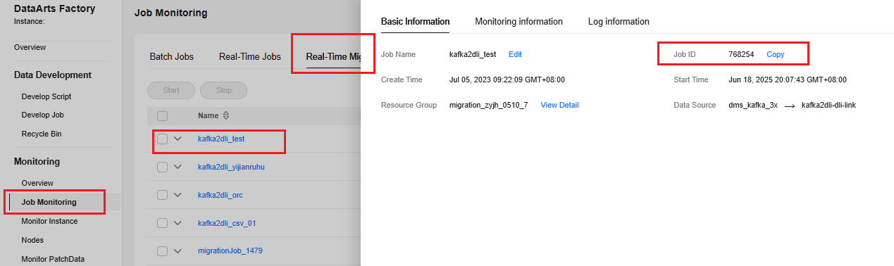

The replication slot name is in migration_Job ID format. You can obtain the job ID on the real-time migration job monitoring page.
- Method 1 Figure 1 Viewing the job ID
- Method 2 Figure 2 Viewing the job ID

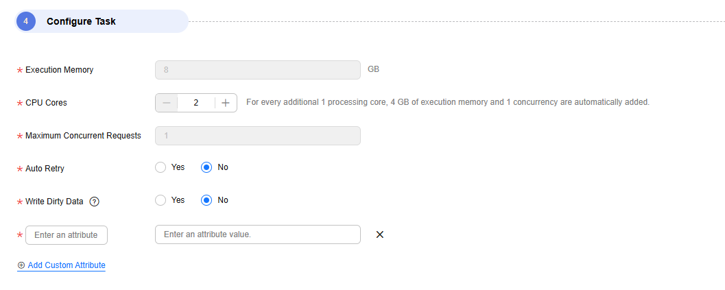

In normal cases, the replication slot used by each job is unique because each job has a unique ID. However, if a custom replication slot is used, conflicts may occur.
- Customize a replication slot. Figure 3 Customizing a replication slot
