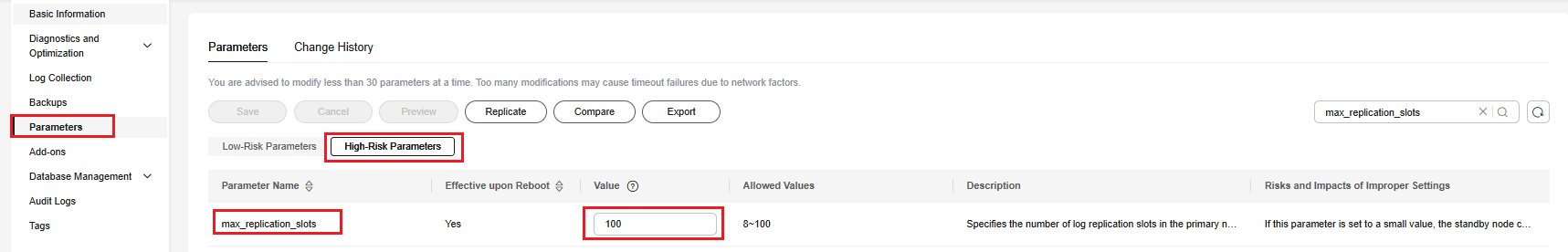

Solution
- Increase the maximum number of replication slots.
- Delete the replication slot that is no longer used.
For details about how to delete replication slots, see How Do I Manually Delete Replication Slots from a PostgreSQL Data Source?.
