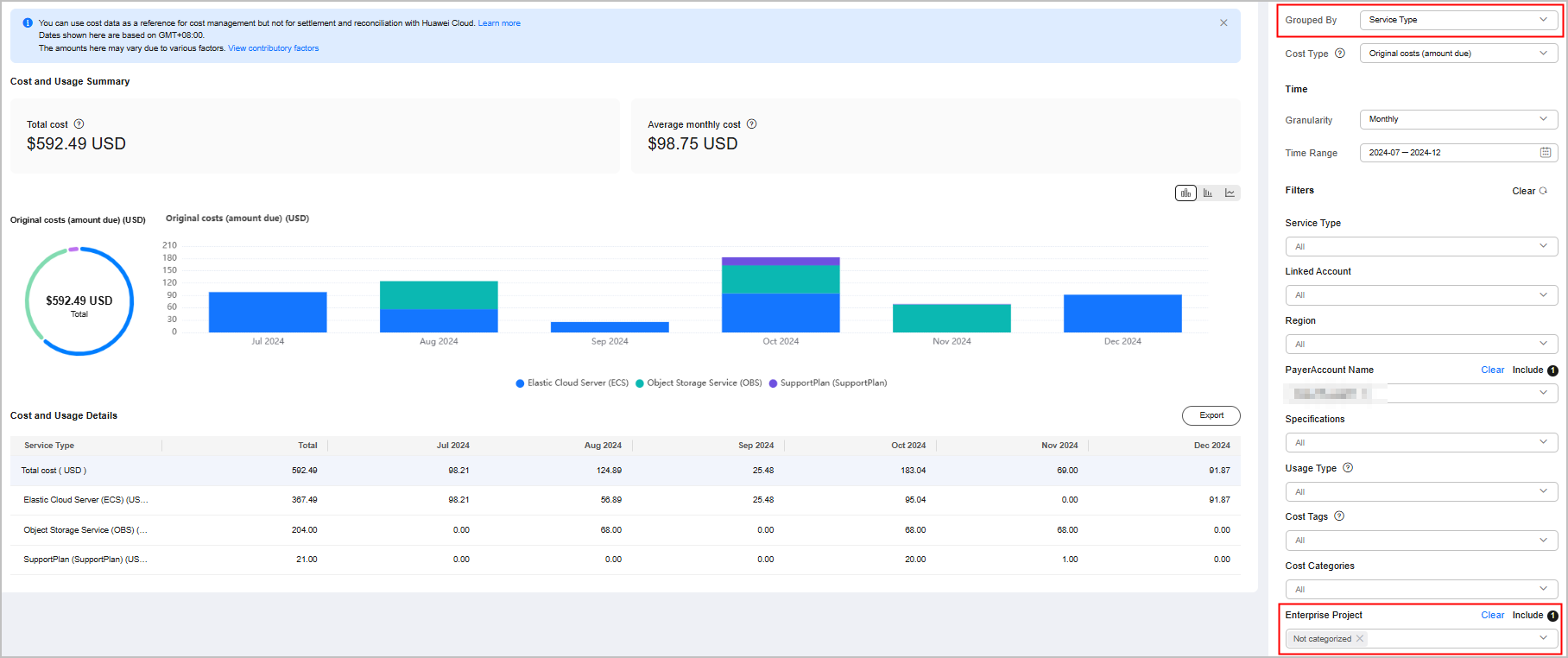

Viewing Uncategorized Cost Data by Enterprise Project
If you want to view the cost data for which Grouped By is set to Service Type and Enterprise Project is set to Not categorized, perform the following steps:
  1. Access the Cost Analysis page.
  2. Click a report name in the report list to view the report details on the Cost Analysis page.
  3. On the Cost Analysis page, set search criteria.
    1. Set Grouped By to Service Type.
    2. Under Filters, set Enterprise Project to Not categorized.
    3. If resources are not well planned or governed, you can set the filter Resource Name/ID to select a specific resource name to view the cost data for that resource.
