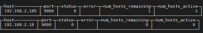

- Create the test table. The result shown in Figure 1 is displayed. The demo database does not exist on other nodes.
CREATE TABLE demo.test ON CLUSTER default_cluster(`EventDate` DateTime, `id` UInt64)ENGINE = ReplicatedMergeTree('/clickhouse/tables/{shard}/default/test', '{replica}') PARTITION BY toYYYYMM(EventDate) ORDER BY id; - Create a database demo on another node and create a table. If the information shown in the following figure is displayed, no error occurs.Figure 2 Successful table creation
