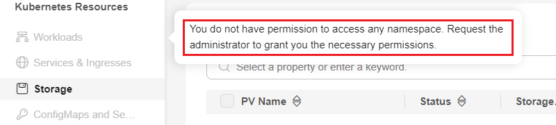

Required RBAC Permissions Not Granted to the Account
Symptom
When you access the console, an error message "You do not have permission to access any namespace. Request the administrator to grant you the necessary permissions." is displayed.
Possible Cause
Your account is not granted the required RBAC permissions.
Solution
- Log in to the IAM management console using a Huawei Cloud account or an account with the administrator permissions. In the navigation pane, choose Users.
- On the Users tab, locate the row containing the username that reports the error and click Authorize.
- Select the required permissions and click OK.
