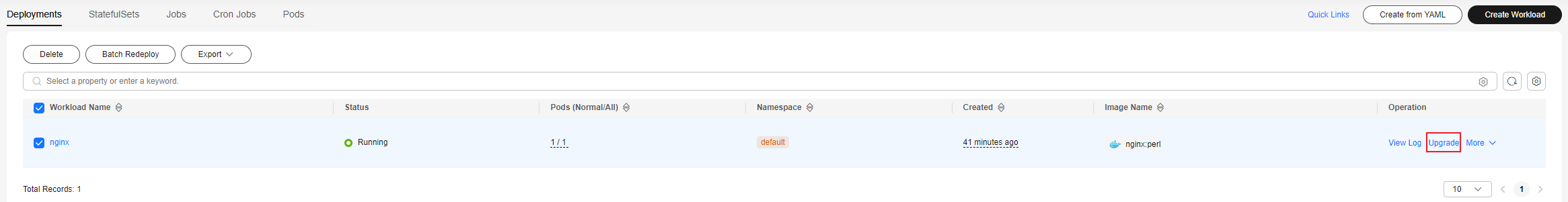

- In the navigation pane, choose Workloads. On the right of the page, locate the target workload and click Upgrade in the Operation column.
         Figure 1 Workload list

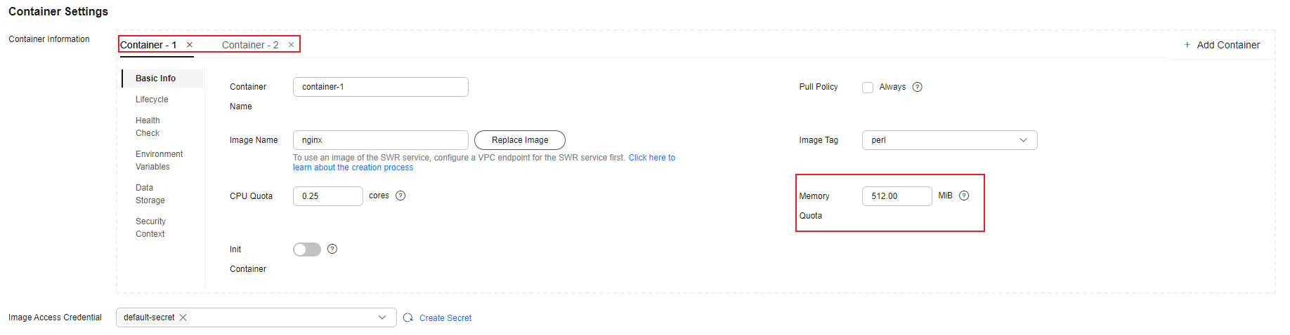

          - In the Container Settings area of the Upgrade Workload page, select a container, click Basic Info, and modify Memory Quota. The memory quota of a pod is the sum of the memory quotas of all containers. You can view Single-Pod Resource Flavor when confirming the specifications.
         Figure 2 Modifying the memory quota
