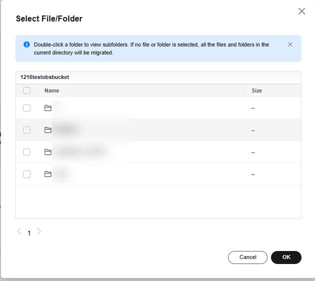

- Click Select. In the Select File/Folder dialog box shown in Figure 5, select one or more files to be migrated and click OK.

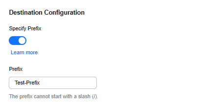

- In the Destination Configuration area, enable Specify Prefix and enter a prefix, for example, Test-Prefix.
Figure 6 Specifying a prefix

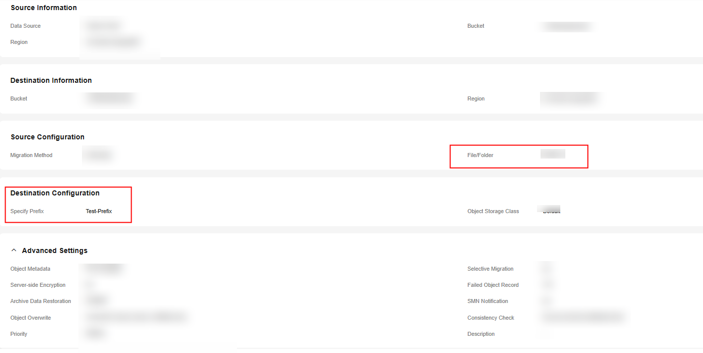

- Click Next to open the confirmation page.
Figure 7 Confirmation
- Confirm the configuration and click Migrate Now.
- After the migration is complete, view the migrated files in the destination bucket. You will see the prefix Test-Prefix has been added to the names of these files.

- Click Select. In the Select File/Folder dialog box shown in Figure 10, select one or more files to be migrated and click OK.

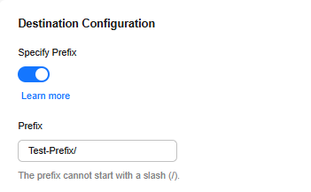

- In the Destination Configuration area, select Yes for Specify Prefix and enter a path prefix, for example, Test-Prefix/.
Figure 11 Specifying a path prefix

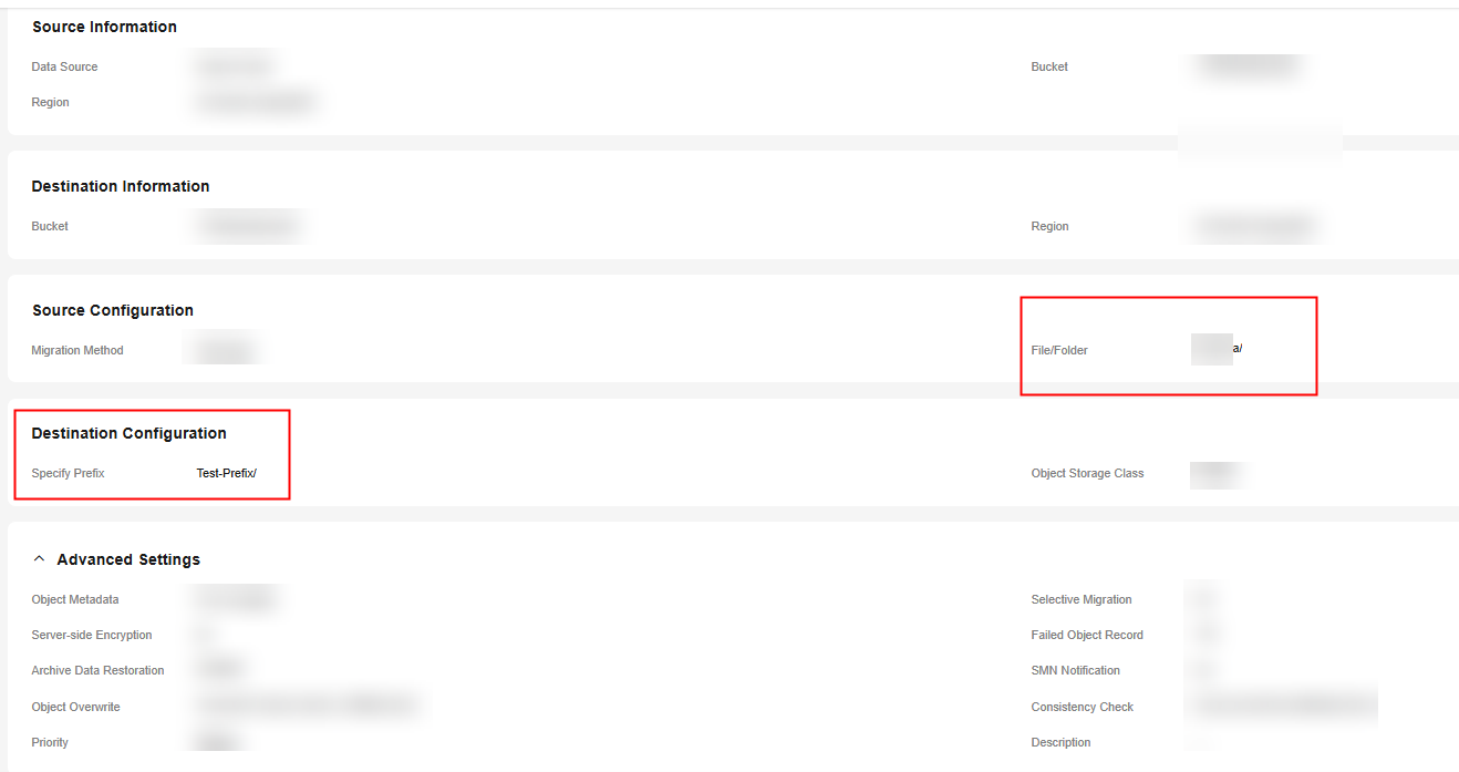

Figure 12 Confirmation
- After the migration is complete, view the migrated files in the destination bucket. You will see that these files are all stored in the Test-Prefix/ directory of the destination bucket.

- Click Select. In the Select File/Folder dialog box shown in Figure 15, select one or more folders to be migrated and click OK.

- Click Select. In the Select File/Folder dialog box shown in Figure 20, select one or more folders to be migrated and click OK.

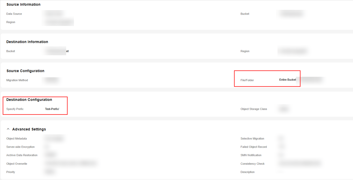

Figure 26 Confirmation
- After the migration is complete, view the directory where the entire bucket is stored. You will see all objects in the source bucket are moved to the Test-Prefix/ directory of the destination bucket.
