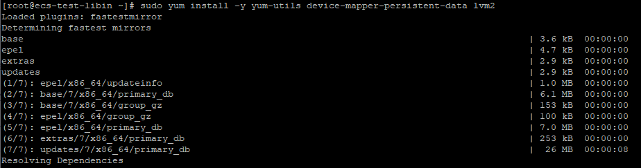

    Installing necessary dependency packages.
    Run the following command:sudo yum install -y yum-utils device-mapper-persistent-data lvm2

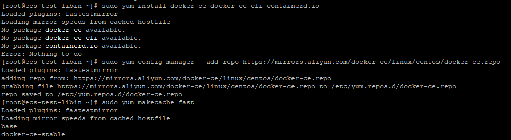

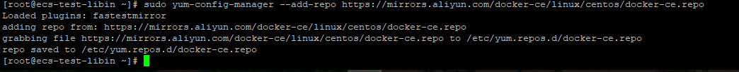

    Setting the Docker Image Source(HUAWEI CLOUD image source is used as an example.)
    Run the following command:sudo yum-config-manager --add-repo https://mirrors.aliyun.com/docker-ce/linux/centos/docker-ce.repo

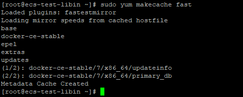

    Updating the YUM Software Package Index
    Run the following command:sudo yum makecache fast
    Installing Docker
    Installing Docker CE of the Latest Version (Community Edition)
    Run the following command:sudo yum install docker-ce docker-ce-cli containerd.io

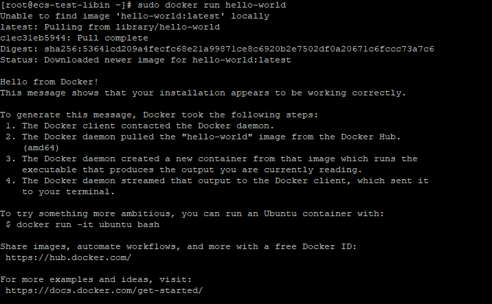

    Test Docker
    Run the following command:sudo docker run hello-world

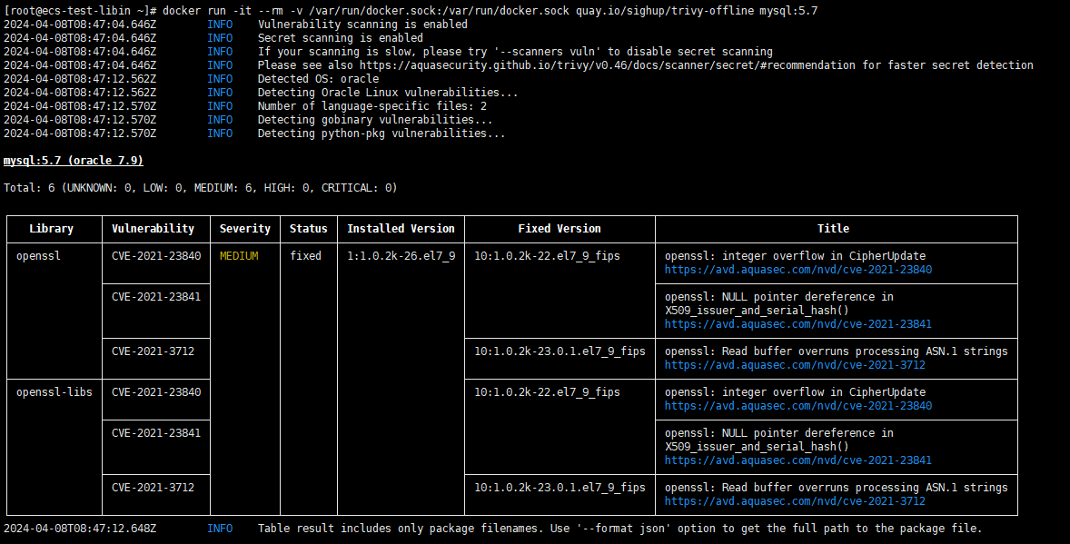

    • Trivy Scanning MySQL Container Images.
      1. Updating the Trivy offline library
        Run the following command:docker pull quay.io/sighup/trivy-offline:latest

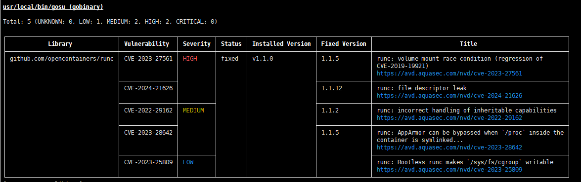

      2. Use Trivy to scan images and provide scan result screenshots.

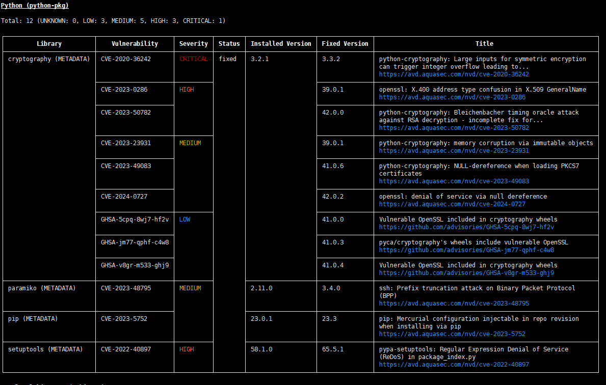

        The test case can be passed only when the number of high-risk and super-risk vulnerabilities is 0. Otherwise, the vulnerability needs to be fixed and then scanned again.
        Run the following command:docker run -it --rm -v /var/run/docker.sock:/var/run/docker.sock quay.io/sighup/trivy-offline mysql:5.7 (Scanning the MySQL:5.7 image offline is used as an example.)
        critical vulnerability:CVE-2020-36242
        high-risk vulnerability:CVE-2023-0286,CVE-2022-40897,CVE-2023-27561
        If the scanning result does not contain vulnerabilities at the HIGH or CRITICAL level, the test case passes. Otherwise, the test case fails,Security vulnerabilities whose severity level is HIGH and CRITICAL need to be fixed.
        Screenshots of basic image vulnerabilities are required for each image. Screenshots of application vulnerabilities are required for each application.Screenshots. Refer to three pictures.

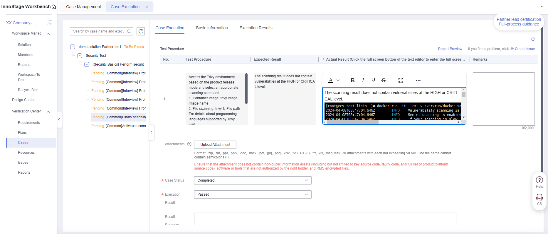

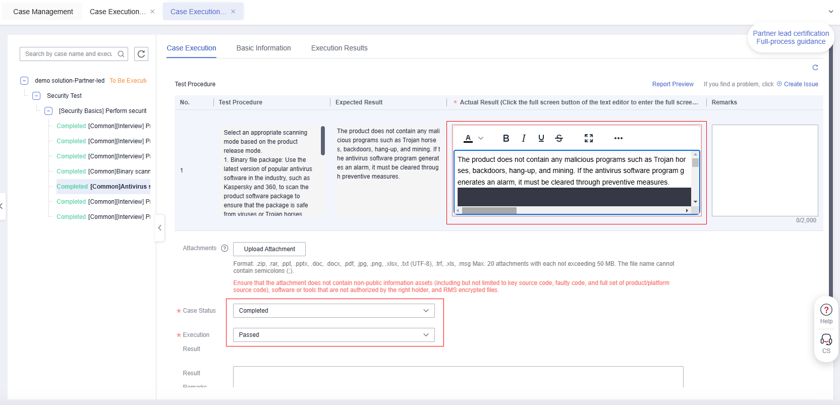

      3. After the scan is passed,go back to the innostage workbench and enter the case management page.Click the [Execution] button of the binary test case.
        Figure 2 Case Management
        Copy the expected result to the actual result, and paste the screenshot in step 2 to the actual result,
        Case Status:Completed
        Execution Result:Passed
        Figure 3 Test Case Execution
        Click[Confirm and go to Next] or click[OK].

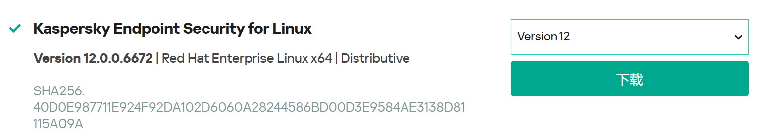

  1. Download
    Select the Kaspersky Endpoint Security installation package based on the OS type:
    https://www.kaspersky.com.cn/small-to-medium-business-security/downloads/endpoint?utm_content=downloads
    • Ubuntu:
    • Centos,Fedora:

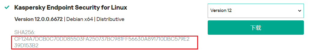

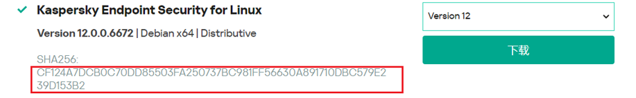

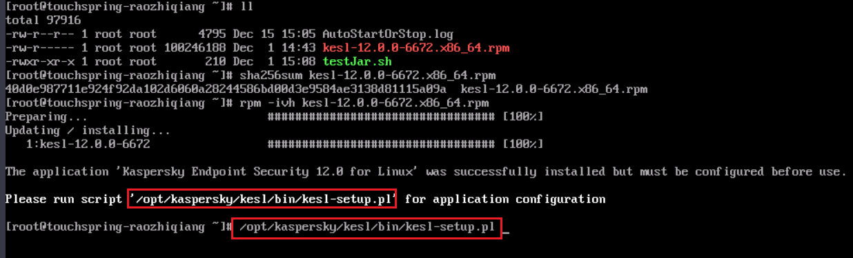

      After the installation package is downloaded, Run the following command:sha256sum <Installation package file>
      Check whether the result is consistent with the downloaded information. If yes, start the installation.
      Figure 4
  2. Installed
    For Red Hat:RPM format:run the following command:rpm -ivh <Installation package file>
    Debian: Deb format:run the following command: dpkg -i <Installation package file>
  3. Initial Configuration
    run the following command:/opt/kaspersky/kesl/bin/kesl-setup.pl script (marked in the red box in the following figure) when the following information is displayed.
    The system prompts you to initialize the configuration.
    1. If the parameters have default values, press "Enter" and wait until the environment initialization is complete.
    2. If there is no default value, enter "y" and wait until the environment initialization is complete.

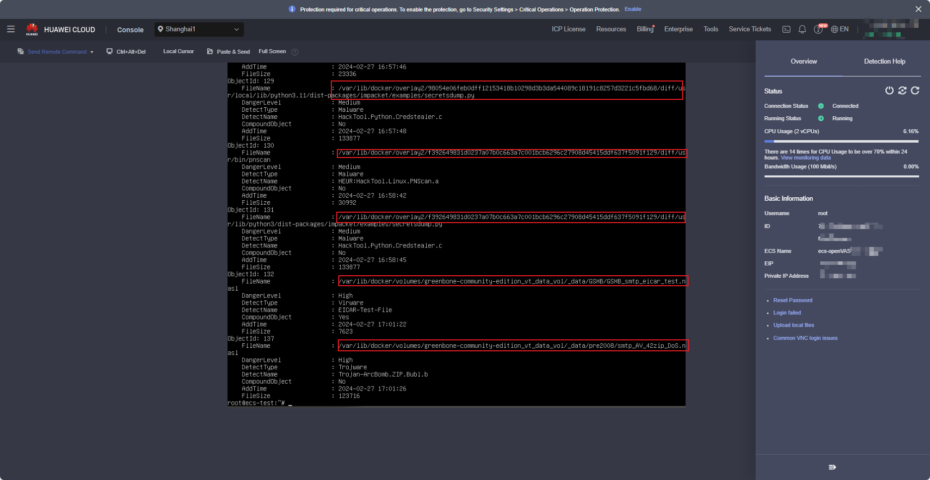

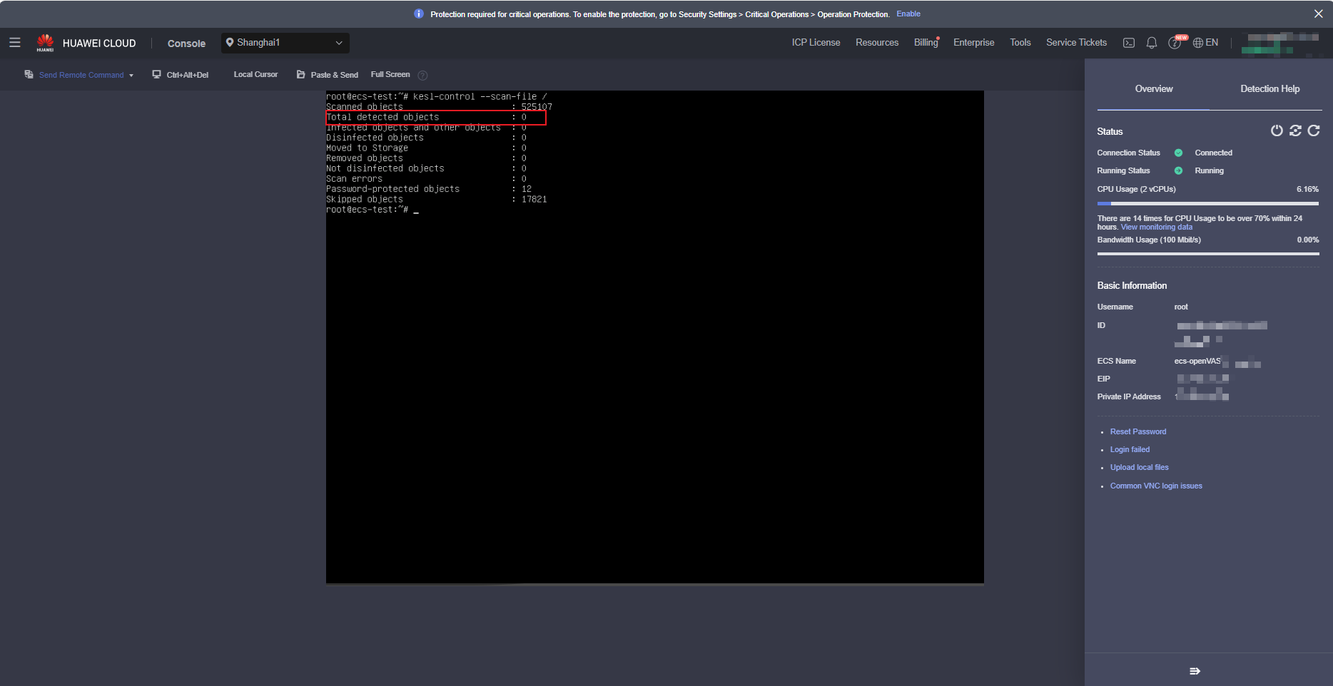

      After the environment is initialized, run the following command:kesl-control --scan-file /
      After the scanning is complete, the scanning result is displayed, as shown in the following figure (screenshot of the remote login page of the ECS console).
      • If the data in the red box is not 0, the result is risky. Generally, the file will be moved to the isolation area.
      • If the value in the red box is 0, it indicates that no virus file is found during the scanning. However, it does not mean that the system is not risky. The reason is that the software may have been automatically scanned and isolated after the software is installed.
      To sum up, the next step is to check the quarantine file.
    2. View quarantine files
      run the following command to view the file in the isolation area:kesl-control -B -query command, as shown in the following figure(Screenshot of the ECS console remote login page).
      Analyze the file. If the file is not used by the image, delete the file. If the file is used by the image, check whether the file is falsely reported. The analysis file is displayed as a document.

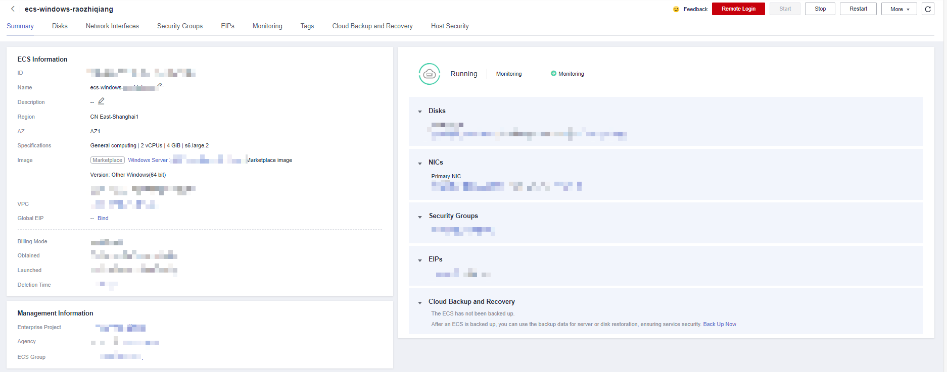

    1. Screenshot of the scanning server
    2. Screenshot of the final full-disk scanning result (screenshot of the remote login page of the ECS console)

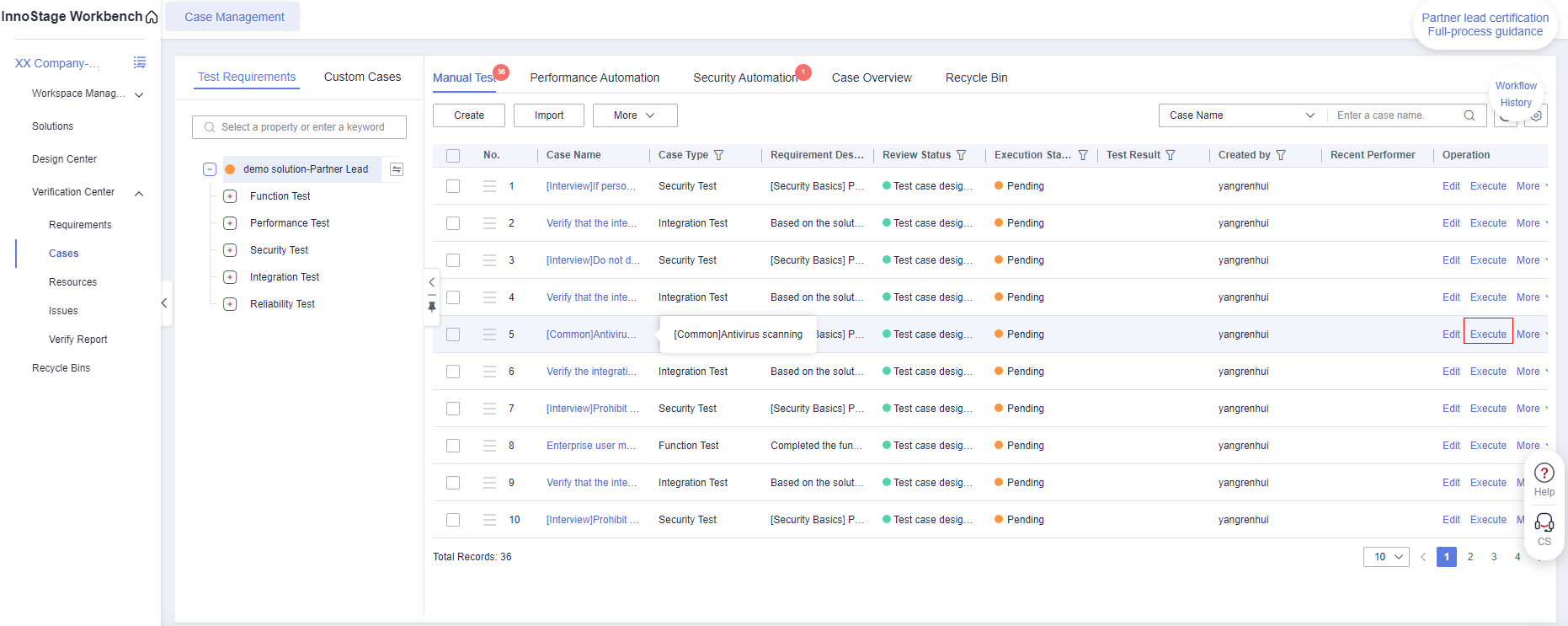

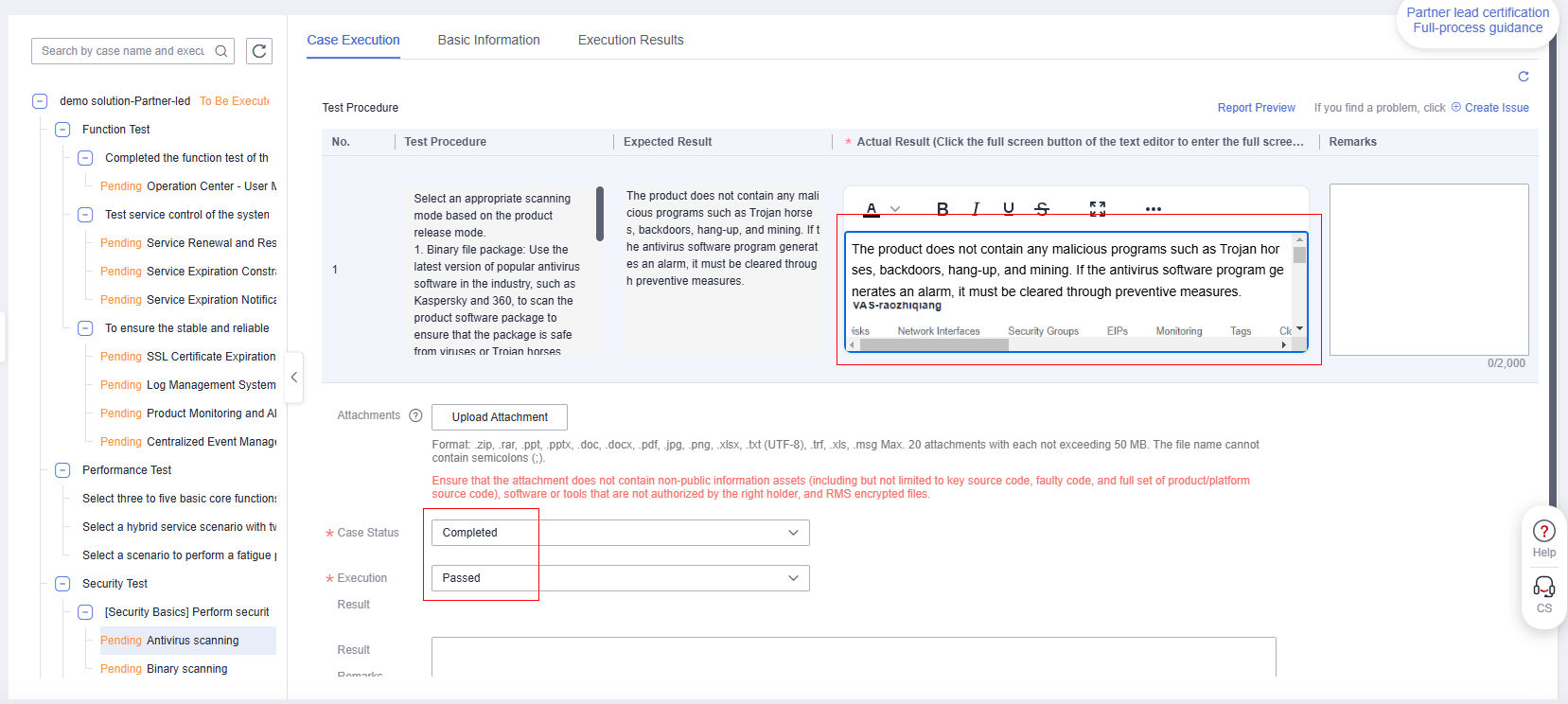

    1. Return to InnoStage Workbench and click the execution button of the "Antivirus scanning" case. The execution page is displayed.
      Figure 5 Test Case Management
    2. If the test case is successfully executed, copy the content in the expected result to the actual result, paste the screenshot obtained in step 5 to the actual result, and click OK.
      Figure 6 Test Case Execution

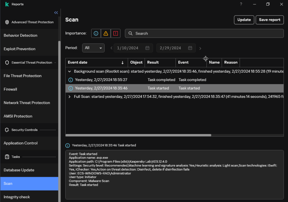

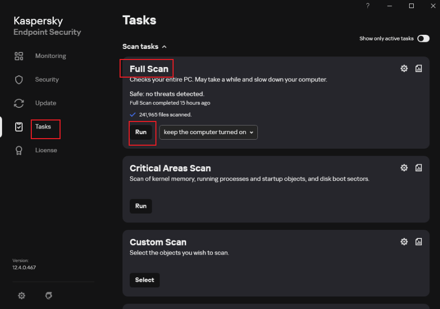

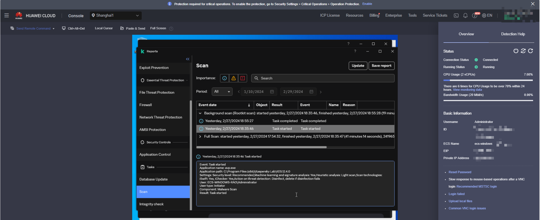

    1. Start Kaspersky, click Task, and click [Run] to start the full disk scanning. Wait until the scanning is complete.
    2. Check whether the latest scanning result contains risky items.
      If no problem is found, only the task start and finished information is displayed in the list. If the scanning has risks, the risk items are displayed in the list. All the risk items need to be resolved and the scanning needs to be performed again.

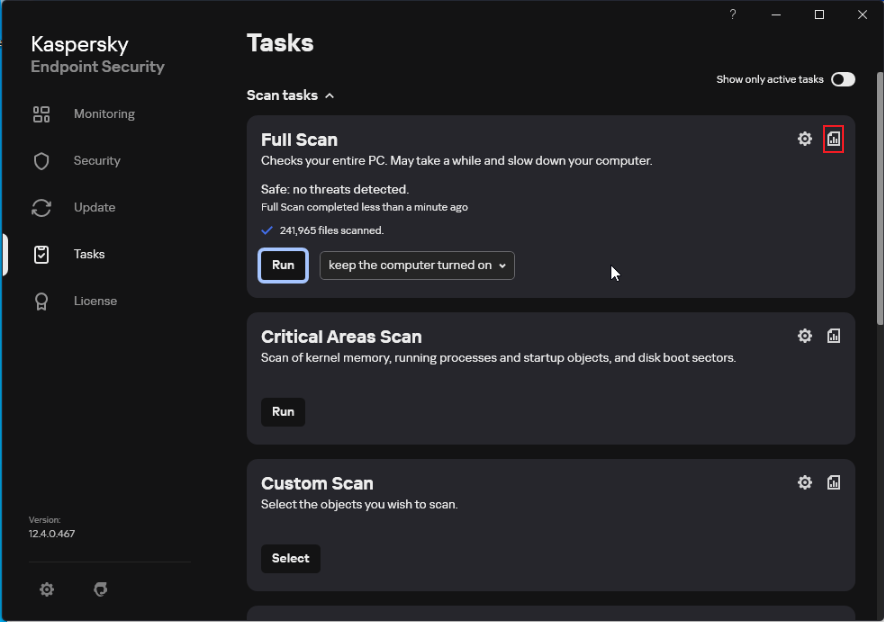

    1. Start Kaspersky, click Task, and click Run to start the full disk scanning. Wait until the scanning is complete.

    • Screenshot of the scanning server
      Figure 9
    • Screenshot of the final full-disk scanning result (screenshot of the remote login page of the ECS console)
      Figure 10
    • Description of the document corresponding to the false positive file (if any)
  5. After the scan is passed,go back to the innostage workbench and enter the case management page.Click the [Execution] button of the binary test case.
    Figure 11 Test Case Management
    Copy the expected result to the actual result, and paste the screenshot in step 4 to the actual result,
    Figure 12 Case Execution
    Figure 13 Test Case Execution
  6. Click[Confirm and go to Next] or click[OK].
