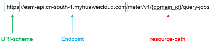

Request URI
A request URI is in the following format:
{URI-scheme}://{Endpoint}/{resource-path}?{query-string}
Although a request URI is included in the request header, most programming languages or frameworks require passing the request URI separately.
| Parameter | Description |
| URI-scheme | Protocol used to transmit requests. All APIs use HTTPS. |
| Endpoint | Domain name or IP address of the server where the REST service is deployed. The value varies depending on services and regions. Obtain the value of this parameter from Regions and Endpoints. For example, the endpoint of ESM in the CN South-Guangzhou region is esm-api.cn-south-1.myhuaweicloud.com. |
| resource-path | Access path of an API. Obtain the path from the URI of an API. For example, resource-path of the API for creating a query task is /meter/v1/{domain_id}/query-jobs. |
| query-string | (Optional) Query parameter. Not all APIs have a query parameter. Ensure that a question mark (?) is included before each query parameter that is in the format of "Parameter name=Parameter value". For example, ?limit=10 indicates that a maximum of 10 data records will be displayed. |
For example, to obtain an ESM token in the CN South-Guangzhou region, obtain the ESM endpoint (esm-api.cn-south-1.myhuaweicloud.com) for this region and the resource-path (/meter/v1/{domain_id}/query-jobs) in the URI of the API used to create a query task. Then, construct the URI as follows:
https://esm-api.cn-south-1.myhuaweicloud.com/meter/v1/{domain_id}/query-jobs
To simplify the URI display, this document provides only the resource-path and request method in the URI of each API. The URI-scheme of all APIs is HTTPS, and the endpoints of all APIs in the same region are identical.
