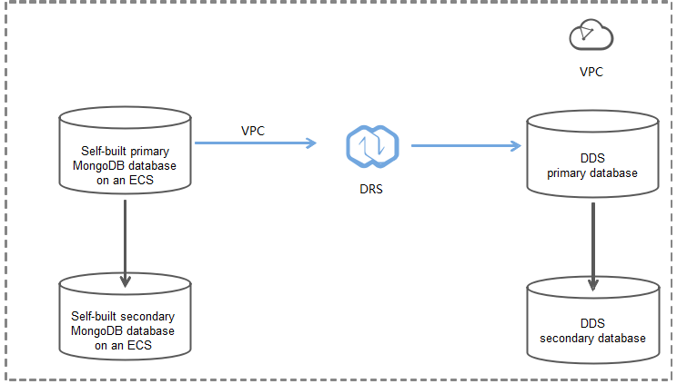

Diagram
Figure 1 Source and destination databases in the same VPC
Figure 2 Source and destination databases in the same region and different VPCs

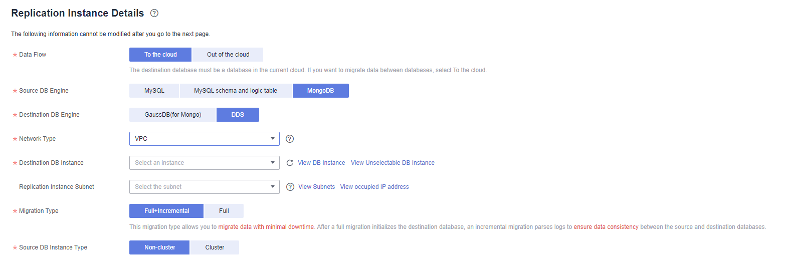

    3. On the Create Replication Instance page, configure the task details, recipient, and replication instance and click Next.
      Figure 4 Replication instance information

      Data Flow
      To the cloud
      Source DB Engine
      Select MongoDB.
      Destination DB Engine
      Select DDS.
      Network Type
      Select VPC.
      Destination DB Instance
      The DDS DB instance you purchased.
      Migration Type
      Select Full+Incremental as an example:
      • Full: This migration type is suitable for scenarios where a service interruption is acceptable. All objects and data in non-system databases are migrated to the destination database at one time. The objects include tables, views, and stored procedures.
        NOTE:
        If you perform a full migration, you are advised to stop operations on the source database. Otherwise, data generated in the source database during the migration will not be synchronized to the destination database.
      • Full+Incremental: This migration type allows you to migrate data without interrupting services. After a full migration initializes the destination database, an incremental migration initiates and parses logs to ensure data consistency between the source and destination databases.
      NOTE:
      If you select the Full+Incremental migration type, data generated during the full migration will be synchronized to the destination database with zero downtime, ensuring that both the source and destination databases remain accessible.
      Source DB Instance Type
      If you select Full+Incremental for Migration Type, set this parameter based on the source database. Non-cluster is selected as an example.
      • If the source database is a cluster instance, set this parameter to Cluster.
      • If the source database is a replica set or a single node instance, set this parameter to Non-cluster.
      Obtain Incremental Data
      This parameter is available for configuration if Source DB Instance Type is set to Cluster. You can determine how to capture data changes during the incremental synchronization.
      • oplog: For MongoDB 3.2 or later, DRS directly connects to each shard of the source DB instance to extract data. If you select this mode, you must disable the balancer of the source instance. When testing the connection, you need to enter the connection information of each shard node of the source instance.
      • changeStream: This method is recommended. For MongoDB 4.0 and later, DRS connects to mongos nodes of the source instance to extract data. If you select this method, you must enable the WiredTiger storage engine of the source instance.
        NOTE:
        Only whitelisted users can use changeStream. To use this function, submit a service ticket. In the upper right corner of the management console, choose Service Tickets > Create Service Ticket to submit a service ticket.
      Source Shard Quantity
      If Source DB Instance Type is set to Cluster and Obtain Incremental Data is set to oplog, enter the number of source shard nodes.
      The default minimum number of source DB instances is 2 and the maximum number is 32. You can set this parameter based on the number of source database shards.

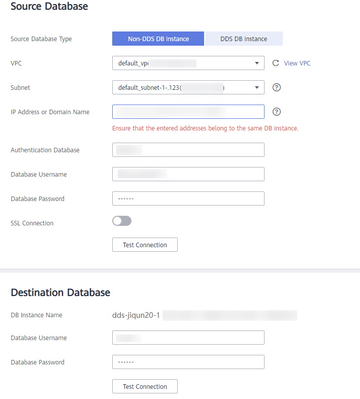

    4. On the Configure Source and Destination Databases page, wait until the replication instance is created. Then, specify source and destination database information and click Test Connection for both the source and destination databases to check whether they have been connected to the replication instance. After the connection tests are successful, select the check box before the agreement and click Next.
      Figure 5 Source and destination database details
      Table 6 Source database information
      Parameter
      Description
      Source Database Type
      Select Self-built on ECS.
      VPC
      A dedicated virtual network in which the source database is located. It isolates networks for different services. You can select an existing VPC or create a VPC. For details on how to create a VPC, see Creating a VPC.
      Subnet
      A subnet provides dedicated network resources that are logically isolated from other networks, improving network security. The subnet must be in the AZ where the source database resides. You need to enable DHCP for creating the source database subnet.
      For details on how to create a VPC, see the Creating a VPC section in the Virtual Private Cloud User Guide.
      IP Address or Domain Name
      The IP address or domain name of the source database.
      Port
      The port of the source database.
      Range: 1 - 65535
      Database Username
      A username for the source database.
      Database Password
      The password for the database username.
      SSL Connection
      To improve data security during the migration, you are advised to enable SSL to encrypt migration links and upload a CA certificate.
      Table 7 Destination database information
      Parameter
      Description
      DB Instance Name
      The DDS DB instance you have selected during the migration task creation is displayed by default and cannot be changed.
      Database Username
      The username for accessing the destination DDS DB instance.
      Database Password
