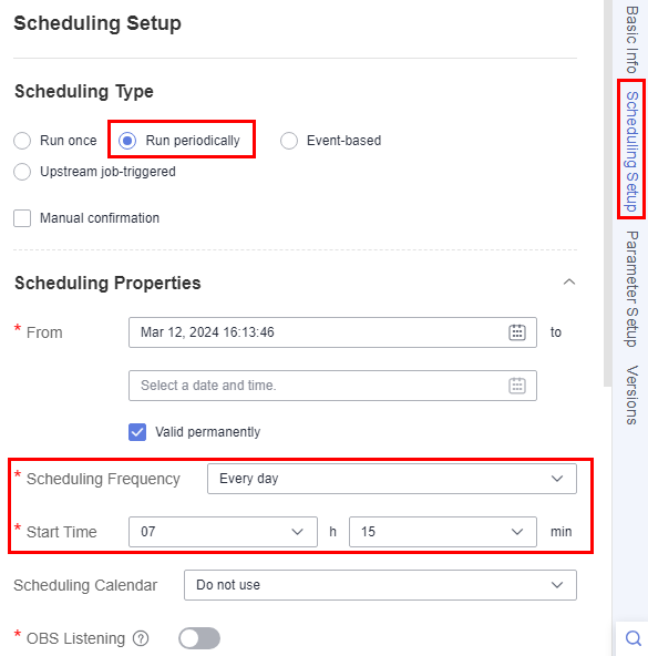

- Create a job that is executed at 07:15 every day.
- In the left navigation pane of DataArts Factory, choose .
- In the job directory, right-click a directory and select Create Job to create a batch processing pipeline job named job_3417_kk02.
- On the job canvas page, select the MRS Spark operator and configure parameters. For details, see MRS Spark.
- Set Scheduling Frequency to Every day. Figure 3 Setting the scheduling frequency to every day

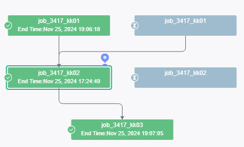

- Configure the dependency of the daily job on the minute-level job.
If you select Recent, the daily job depends only on the minute-level job's instance that is closest to its scheduled execution time.
Figure 4 Configuring dependency attributes

- Click More in the Operation column and select View Latest Instance DAG to view the job instance dependency. Figure 6 Job instance dependency
