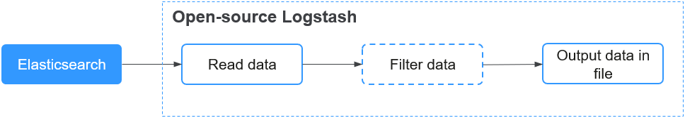

Solution Architecture
Figure 1 Using open-source Logstash to export data from Elasticsearch
This solution consists of three key components:
  • Input (reading data): The logstash-input-elasticsearch plugin connects to a CSS cluster to read data from specified indexes.
  • Filter (filtering data): This one is optional. It is used for data cleaning (such as filtering data by field and converting formats).
  • Output (outputting data in file): The logstash-output-file plugin writes data to a local JSON file.

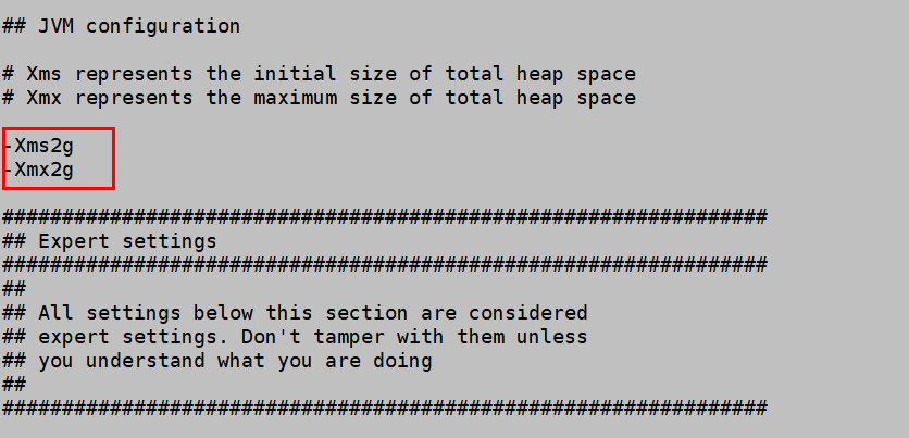

  3. Modify the Logstash memory configuration.
    Change the JVM heap size for Logstash. The default value is 1 GB. We recommend that you set it to half of the ECS memory.
    cd logstash-7.10.2
    vi config/jvm.options
    Figure 2 shows an example.
    Figure 2 Changing the JVM heap size for Logstash
