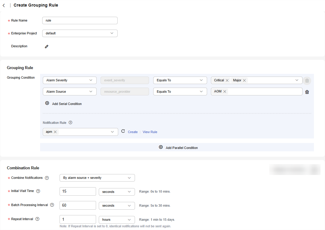

When a critical or major alarm is generated, the apm notification rule is triggered, and alarms are grouped by alarm source. To create a grouping rule, do as follows:
  1. Log in to the AOM 2.0 console.
  2. In the navigation pane, choose Alarm Center > Alarm Noise Reduction.
  3. On the Grouping Rules tab page, click Create. On the displayed page, set the rule name, enterprise project, and grouping rule.
    Figure 1 Creating a grouping rule
    Table 1 Grouping rule parameters
    Parameter
    Description
    Example Value
    Rule Name
    Name of a grouping rule.
    Enter up to 100 characters and do not start or end with an underscore (_). Only letters, digits, and underscores are allowed.
    rule
    Enterprise Project
    Enterprise project name.
    • If Enterprise Project is set to All on the global settings page, select an enterprise project from the drop-down list here.
    • If you have already selected an enterprise project on the global settings page, this option will be grayed and cannot be changed.
    default
    Description
    Description of a grouping rule. Enter up to 1,024 characters. In this example, leave this parameter blank.
    Grouping Condition
    Conditions set to filter alarms. After alarms are filtered out, you can set alarm notification rules for them.
    • Alarm Severity: severity of a metric or event alarm. Options: Critical, Major, Minor, and Warning.
    • Alarm Source: name of the service that triggers the alarm or event. Options: include AOM, LTS, and CCE.
    • Alarm Severity + Equals to + Critical & Major
    • Alarm Source + Equals to + AOM
    Notification Rule
    You can associate an alarm notification rule with an SMN topic and a message template. If the log, or resource or metric data meets the alarm condition, the system sends an alarm notification based on the associated SMN topic and message template.
    apm
    Combine Notifications
    Combines grouped alarms based on specified fields. Alarms in the same group are aggregated for sending one notification. In this example, select By alarm source + severity.
    By alarm source + severity: Alarms triggered by the same alarm source and of the same severity are combined into one group for sending notifications.
    Initial Wait Time
    Interval for sending an alarm notification after alarms are combined for the first time. It is recommended that the time be set to seconds to prevent alarm storms.
    15s
    Batch Processing Interval
    Waiting time for sending an alarm notification after the combined alarm data changes. The change here refers to a new alarm or an alarm status change.
    60s
    Repeat Interval
    Waiting time for sending an alarm notification after the combined alarm data becomes duplicate. Duplication means that no new alarm is generated and no alarm status is changed while other attributes (such as titles and content) are changed.
    1 hour
  4. Click Confirm. The grouping rule is created. You can view the new rule in the grouping rule list.
