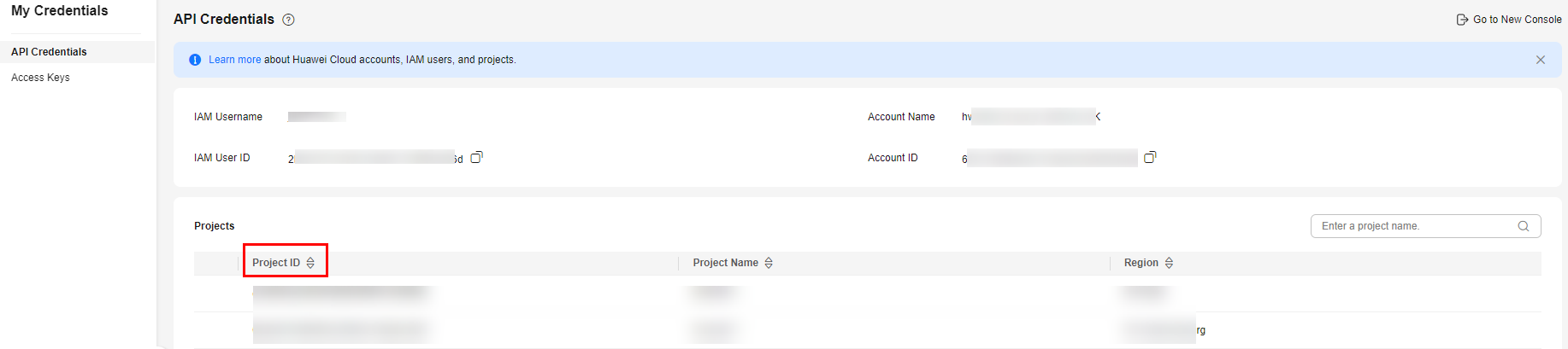

Obtain the Project ID from the Console
To obtain a project ID from the console, perform the following operations:
  1. Log in to the management console.
  2. Click the username and select My Credentials from the drop-down list.
    On the API Credentials page, view the project ID in the project list.
Figure 1 Viewing the project ID
