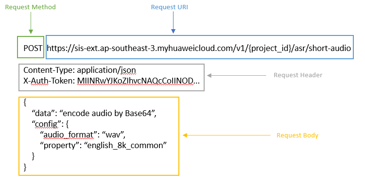

Figure 1 shows an example request. A request consists of the request URI, request method, request header, and request body.

For details about how to obtain the request URI, see Request URI. The following is an example:
https://{endpoint}/v1/{project_id}/deployments/{deployment_id}/chat/completions
 Request Methods
HTTP request method, which indicates the type of operation that the service is requesting. The options are as follows:
- GET: requests the server to return specified resources.
 - PUT: requests the server to update specified resources.
 - POST: requests the server to add resources or perform special operations.
 - DELETE: requests the server to delete specified resources, for example, an object.
 - HEAD: same as GET except that the server must return only the response header.
 - PATCH: requests the server to update partial content of a specified resource. If the resource does not exist, a new resource will be created.
The request method in the URI of the API is POST, for example:
POST https://{endpoint}/v1/{project_id}/deployments/{deployment_id}/chat/completions
 Request Header
You can also add additional header fields to a request, such as the fields required by a specified URI or HTTP method. For example, to request for the authentication information, add Content-Type, which specifies the request body type.
Common request headers are as follows:
- Content-Type: specifies the request body type or format. This field is mandatory and its default value is application/json.
 - X-Auth-Token: specifies a user token only for token-based API authentication. For details about user tokens, see Token-based Authentication in Authentication.
     In addition to supporting token-based authentication, APIs also support authentication using access key ID/secret access key (AK/SK). During AK/SK-based authentication, an SDK is used to sign the request, and the Authorization (signature information) and X-Sdk-Date (time when the request is sent) header fields are automatically added to the request. For more details, see Authentication.
The following provides an example request with a header included.
Content-Type: application/json
X-Auth-Token: MIINRwYJKoZIhvcNAQcCoIINOD...
 Request Body
The body of a request is often sent in a structured format as specified in the Content-Type header field. The request body transfers content except the request header. If the request body contains Chinese characters, these characters must be coded in UTF-8.
The request body varies between APIs. Some APIs do not require the request body, such as the APIs requested using the GET and DELETE methods.
    "messages": [
          "content": "Introduce the Yangtze River and its typical fish species."
    "temperature": 0.9,
    "max_tokens": 600
  You can send the request to call an API through curl, Postman, or coding. For an API, you can obtain the request parameters and parameter descriptions in the response.
