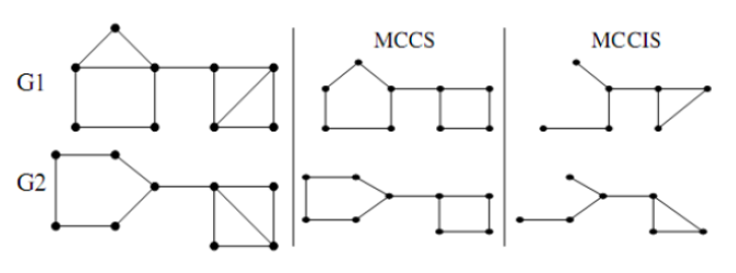

The MCCIS algorithm is suitable for calculating the similarity between two graphs.
similarity =2*|E(mccis)| / (|E(G1) + |E(G2)|)
