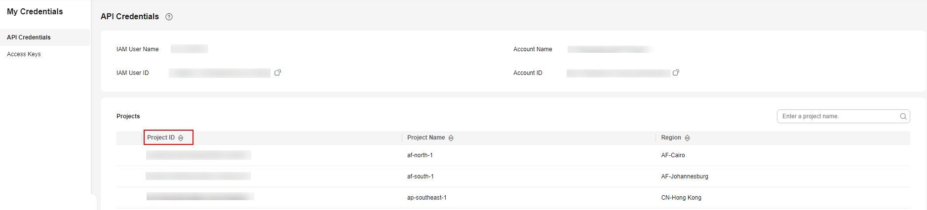

Obtain a Project ID from the Console
To obtain a project ID from the console, perform the following operations:
  1. Access My Credentials.
  2. On the API Credentials page, check the project ID in the project list.
Figure 1 Viewing the project ID
