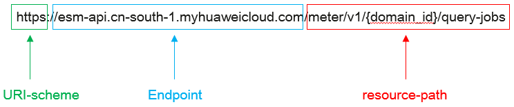

For example, to obtain an ESM token in the CN South-Guangzhou region, obtain the ESM endpoint (esm-api.cn-south-1.myhuaweicloud.com) for this region and the resource-path (/meter/v1/{domain_id}/query-jobs) in the URI of the API used to create a query task. Then, construct the URI as follows:
https://esm-api.cn-south-1.myhuaweicloud.com/meter/v1/{domain_id}/query-jobs
Figure 1 Example URI
To simplify the URI display, this document provides only the resource-path and request method in the URI of each API. The URI-scheme of all APIs is HTTPS, and the endpoints of all APIs in the same region are identical.
