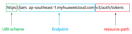

For example, to obtain an IAM token in the CN-Hong Kong region, obtain the endpoint of IAM (iam.ap-southeast-1.myhuaweicloud.com) for this region and the resource-path (/v3/auth/tokens) in the URI of the Obtaining a User Token API. Then, construct the URI as follows:
https://iam.ap-southeast-1.myhuaweicloud.com/v3/auth/tokens
Figure 1 Example URI
To simplify the URI display, each API is provided with only a resource-path and a request method. This is because the URI-scheme value of all APIs is HTTPS, and the endpoints in a region are the same. Therefore, the two parts are omitted.
