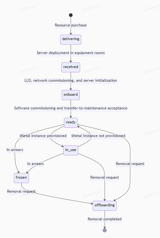

manage_state
String
Definition
Server management status.
Constraints
N/A
Value Range
  • onboard: The server is being provisioned. You can place an order and complete the LLD design.
  • ready: The delivery is complete, including hardware installation, network commissioning, server initialization, software commissioning, and transfer-to-maintenance acceptance.
  • in-use: The server is provisioned and in use.
  • frozen: Resources are frozen due to arrears.
  • offboarding: The server is being removed.
Default Value
N/A
