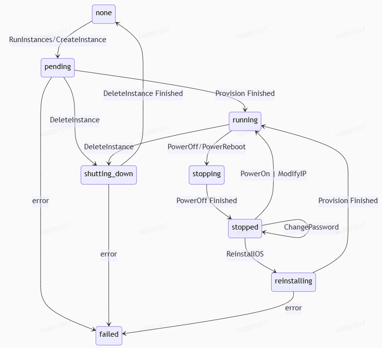

state
String
Definition
The instance status.
Constraints
N/A
Range
  • pending: The instance is being started (resources are being allocated or the OS is being started).
  • running: The instance is running properly (can be connected through SSH or RDP).
  • stopped: The instance is completely stopped (storage volumes are retained).
  • shutting-down: The instance is being terminated (being deleted).
  • terminated: The instance has been terminated (all resources are deleted and cannot be restored).
  • error: The instance is abnormal (resources are not completely deleted).
stateDiagram-v2
    [*] --> pending: CreateInstance
    pending --> running: CreateInstance Succeed
    pending --> shutting_down: DeleteInstance
    running --> stopped: PowerOff/PowerReboot
    stopped --> running: PowerOn/Provision Succeed
    stopped --> stopped: ChangePassword
    pending --> error: CreateInstance Failed
    stopped --> error: Provision Failed
    error --> running: Retry Provision Succeed
    stopped --> shutting_down: DeleteInstance
    error --> shutting_down: Retry DeleteInstance
    shutting_down --> error: DeleteInstance Failed
    shutting_down --> terminated: DeleteInstance Succeed
