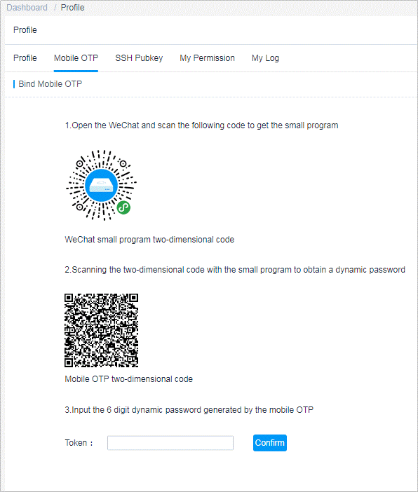

Step 2: Bind a Mobile OTP as a Common User
Built-in Mobile OTP
  1. Log in to your bastion host using your static password.
  2. On the Dashboard page, click the user name in the upper right corner and choose Profile.
  3. On the displayed Profile page, click the Mobile OTP tab.
    On the displayed page, follow the instructions to bind a mobile OTP.
    Figure 1 Mobile OTP configuration
    If you do not have the WeChat app, use the Google verification code program to scan the second QR code.
  4. (Optional) To unbind the mobile OTP, click Unbind on the Mobile OTP tab.
