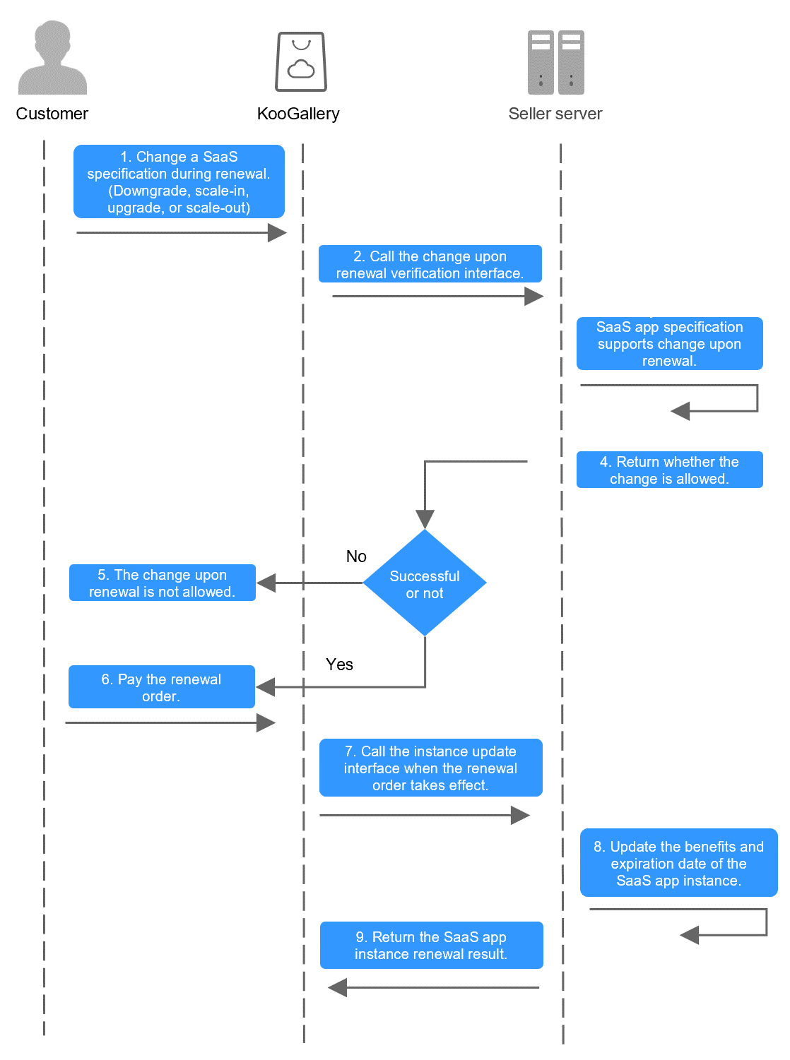

When a customer requests to upgrade or downgrade resource specifications or scale in or scale out resources during renewal, KooGallery calls this interface to check whether your server supports such changes.
Before downgrading specifications, verify resource usage. Ensure that it stays within the reduced quota to avoid data loss or service unavailability.
- If you receive an email indicating that the interface fails to be called in your email address of customer service or that one bound to your KooGallery account, handle the exception in a timely manner.
- KooGallery monitors interface exceptions. If a product has frequent interface exceptions, KooGallery will remove the product from the catalog.
The following figure shows the process of upgrading a product.
