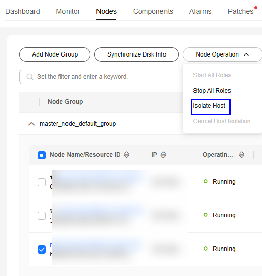

- Log in to the MRS console.
- On the Active Clusters page, select a running cluster and click its name to switch to the cluster details page.
- On the cluster details page, click Nodes.
- Unfold the node group information and select the check box of the target host.
- Choose Node Operation > Isolate Host.
Isolating a host stops all role instances on it, which may cause service faults and interruptions. During isolation, the host and its instances cannot be started, stopped, or configured. If components such as HDFS, ClickHouse, Kafka, and Kudu are installed on the host and all replica nodes become isolated, the services may fail. Proceed only during off-peak hours or after confirming that the operation will not have any adverse impacts.
Figure 1 Isolating a host
- Confirm the information about the host to be isolated and click OK.
When Operation successful is displayed, click Finish. The host is isolated successfully, and the value of Operating Status becomes Isolated.
