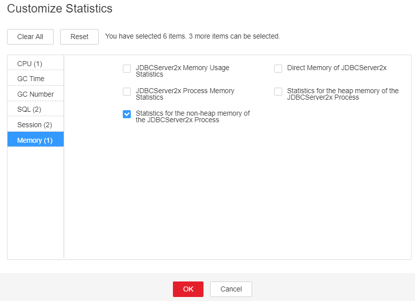

- On the FusionInsight Manager home page, choose Cluster > Services > Spark2x > Instance. Click JDBCServer2x by which the alarm is reported to go to the Dashboard page, click the drop-down list in the upper right corner of the chart area, choose Customize > Memory > Statistics for the non-heap memory of the JDBCServer2x Process, and click OK. Based on the alarm generation time, check the values of the used non-heap memory of the JDBCServer2x process in the corresponding period and obtain the maximum value.
