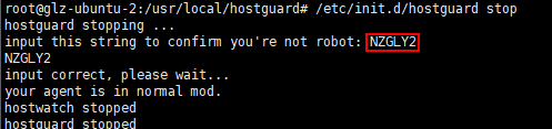

    2. Perform the following operations to stop HSS:
      1. Run the following command to stop the service:
        /etc/init.d/hostguard stop
      2. (Optional) Enter the verification code displayed in the command output. See Figure 2.
        This operation is required only for servers where HSS self-protection is enabled.
