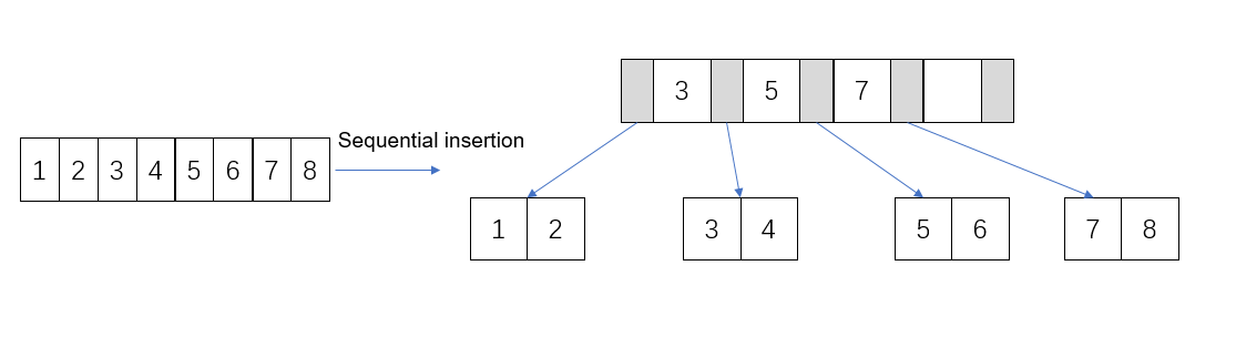

  • Cause 1: During a full migration, DRS uses row-level parallel migration to ensure migration performance and transmission stability. If the source database data is compact, there may be table bloat after data is migrated to the cloud. As a result, the disk space required is much greater than that of the source database.
    For details about the sequential insertion principle in parallel, see Figure 1.
    Figure 1 Sequential insertion

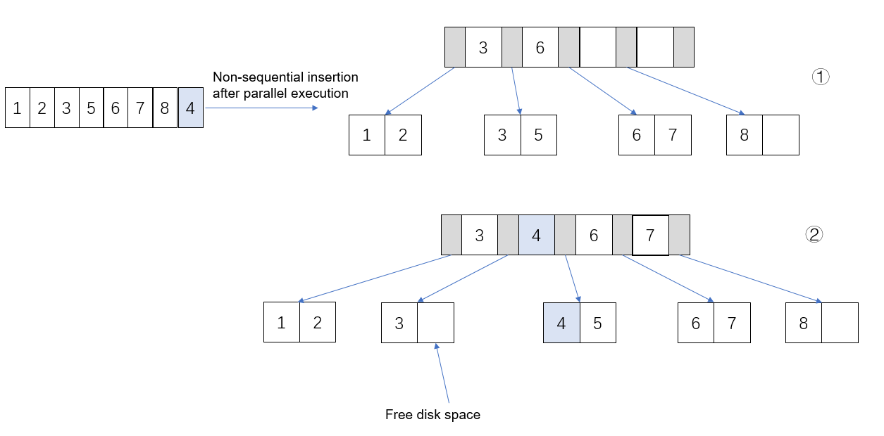

    If data is inserted in a non-sequential manner after parallel execution, as shown in Figure 2, and data 4 is inserted at last, leaf nodes 3 and 5 are split, and the split leaf nodes have free disk space.
    Figure 2 Non-sequential insertion after parallel execution
