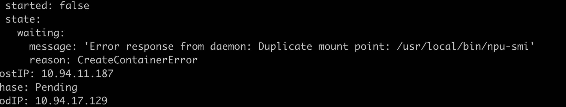

After upgrading the CCE AI Suite (Ascend NPU) add-on from 1.x.x to 2.x.x but deploying services using the original configuration, a service pod remains in the pending state and cannot start.
Running the kubectl describe pod command reveals an error message, which indicates that the container creation has failed.
Error response from daemon: Duplicate mount point: /usr/local/bin/npu-smi
