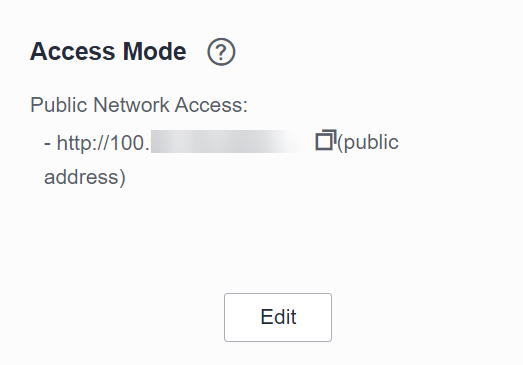

  1. Choose Components.
  2. Select the nacos-consumer component and click in the Access Address column to obtain the automatically generated external network access address.
    Figure 1 Obtaining the external network access address

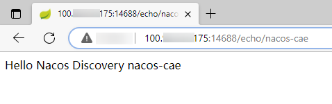

  3. In the address box of the browser, enter http://External network access IP address:Access port/echo/{string}. The external network access IP address and access port are obtained in 2, and {string} is a custom string. Example: http://100.**.**.175:14688/echo/nacos-cae.
    If the welcome page shown in the following figure is displayed, Nacos is successfully called.
    Figure 2 Calling a microservice engine
